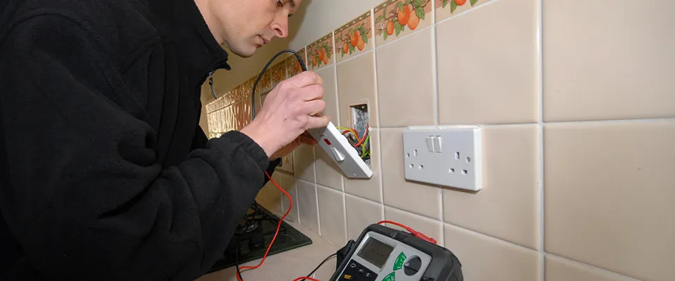

Sampling
Whilst this concept may be more relevant to larger or complex installations it often causes contention and can lead to liability issues if incorrectly applied to smaller installations such as residential properties.
Guidance given by the Electrical Safety Roundtable suggests that 100% of a residential installation should be tested to ensure it is safe for continued use, with a further recommendation for at least 20% of all wiring accessories to be opened up for a detailed internal examination.
Fig 1: At least 20% of wiring accessories should be examined
Fig 1 At Least 20 Per Cent Of Wiring Accessories Should Be Examined
Whilst a full examination of all accessible parts of an installation would be considered to be best practice, in reality, this may sometimes be impractical.
Where limits apply to what can be/will be inspected, right at the outset these need to be formally agreed with the person ordering the work. As a practitioner undertaking such inspections, it will be essential to fully detail these on the report, together with the name of the person with which it has been agreed.
Finally remember – the more exclusions or limitations a report contains, the less use it will be!
