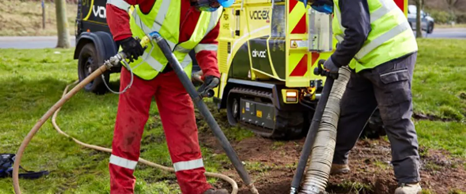

Another method is vacuum excavation, which is basically a large vacuum cleaner that uses compressed air and powerful fans to create a vacuum to remove the material from the ground, eliminating the risk of mechanical damage to services. At first this might seem like a costly option but when compared to serious injury or repair bills for services it is definitely worth consideration.
