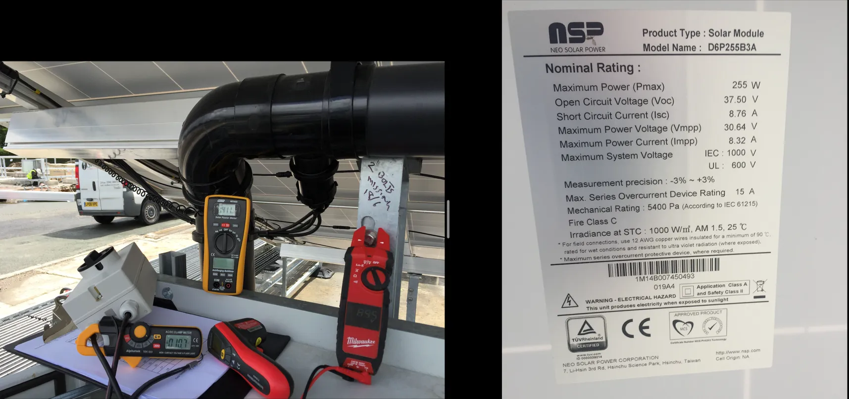

It is worth noting, some PV module manufacturers also include nominal operating cell temperature (NOCT) values. These values are not representative of the worst-case conditions and shall not be used when determining the voltage and current of the system for selection of equipment.
Figure 1: Current measurement in high irradiance. North-West England 7 July 2015

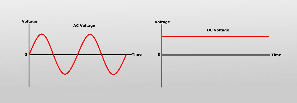

Where a means of isolation is required for the inverter, this should be rated for on-load interruption. Interrupting a DC circuit is more difficult than interrupting an equivalent AC circuit. A 50 Hz AC supply has a zero-point crossing every 10 milliseconds, which helps extinguish the arc within the switching device during on-load operation (breaking). In contrast, a DC system has no zero-point crossing; instead, the contacts of the switching device must withstand a much stronger and more sustained electrical arc.
To disconnect the equivalent current as an AC system, DC switch-disconnectors often employ spring-loaded mechanisms and specially designed contacts. In addition, multiple contacts or poles may be used, helping to elongate and dissipate the DC arc as it ionizes the air between the switching contacts.
Future standards are being developed to address some of the challenges associated with DC switching. Some of these standards use technologies that differ from conventional electromechanical devices, such as semiconductor circuit-breakers (IEC 60947-10).

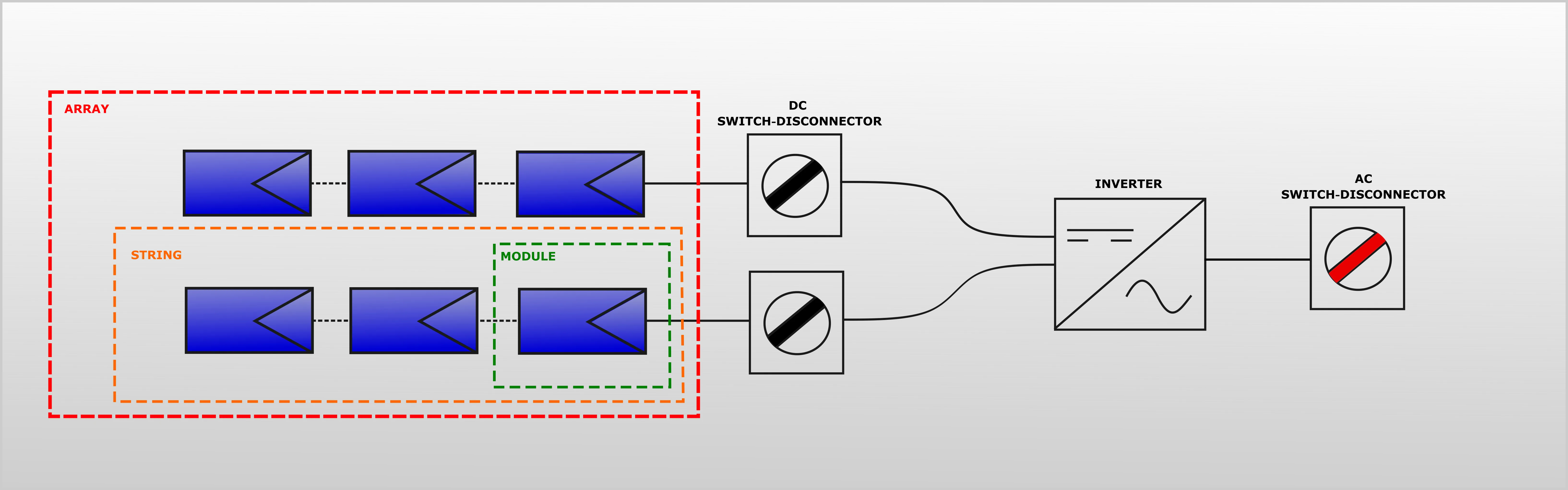

Solar PV arrays are divided into strings. Smaller domestic PV systems can have just one string, while larger systems can have many.
A string is essentially a circuit of PV modules connected in series. With each additional module in a string, the voltage increases. The number of modules in a string depends on several factors, including the:
  • voltage rating of the PV module
  • available roof space
  • inverter’s minimum voltage rating (start-up voltage)
  • inverter’s maximum voltage rating.
Figure 3: Simplistic PV array block diagram

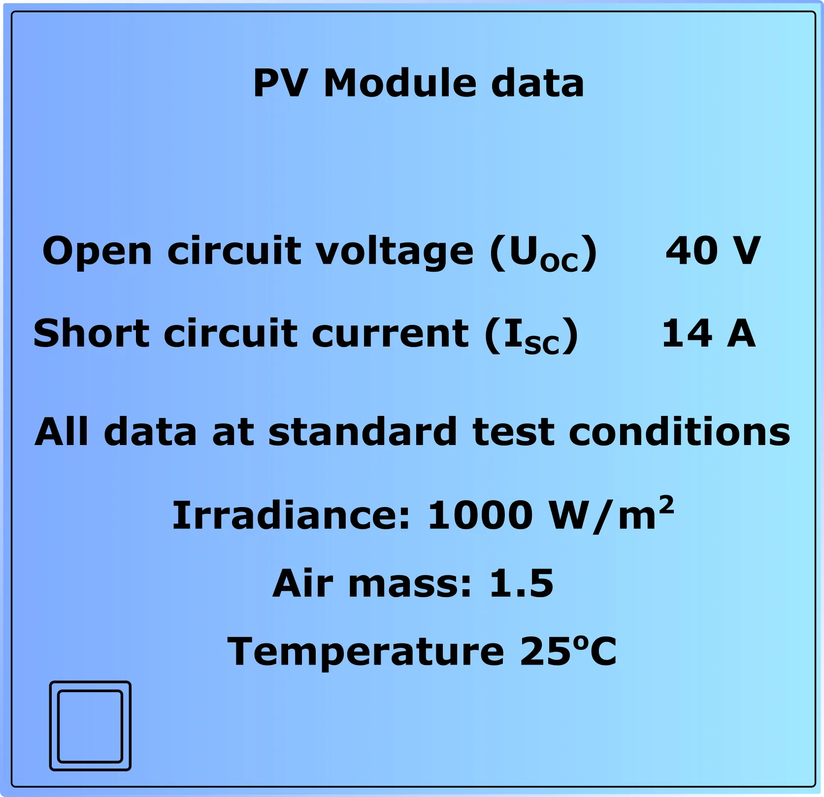

As an example, if a PV module was selected, as shown in Figure 4, and the designer choses a ten module string, the maximum open-circuit voltage (Uoc MAX) is calculated as per Equation 1 using Formula 1 from earlier.
Equation 1 Determining design voltage
UOC MAX = No. of modules × UOC STC × 1.2
UOC MAX = 10 × 40 V × 1.2
UOC MAX = 480 V

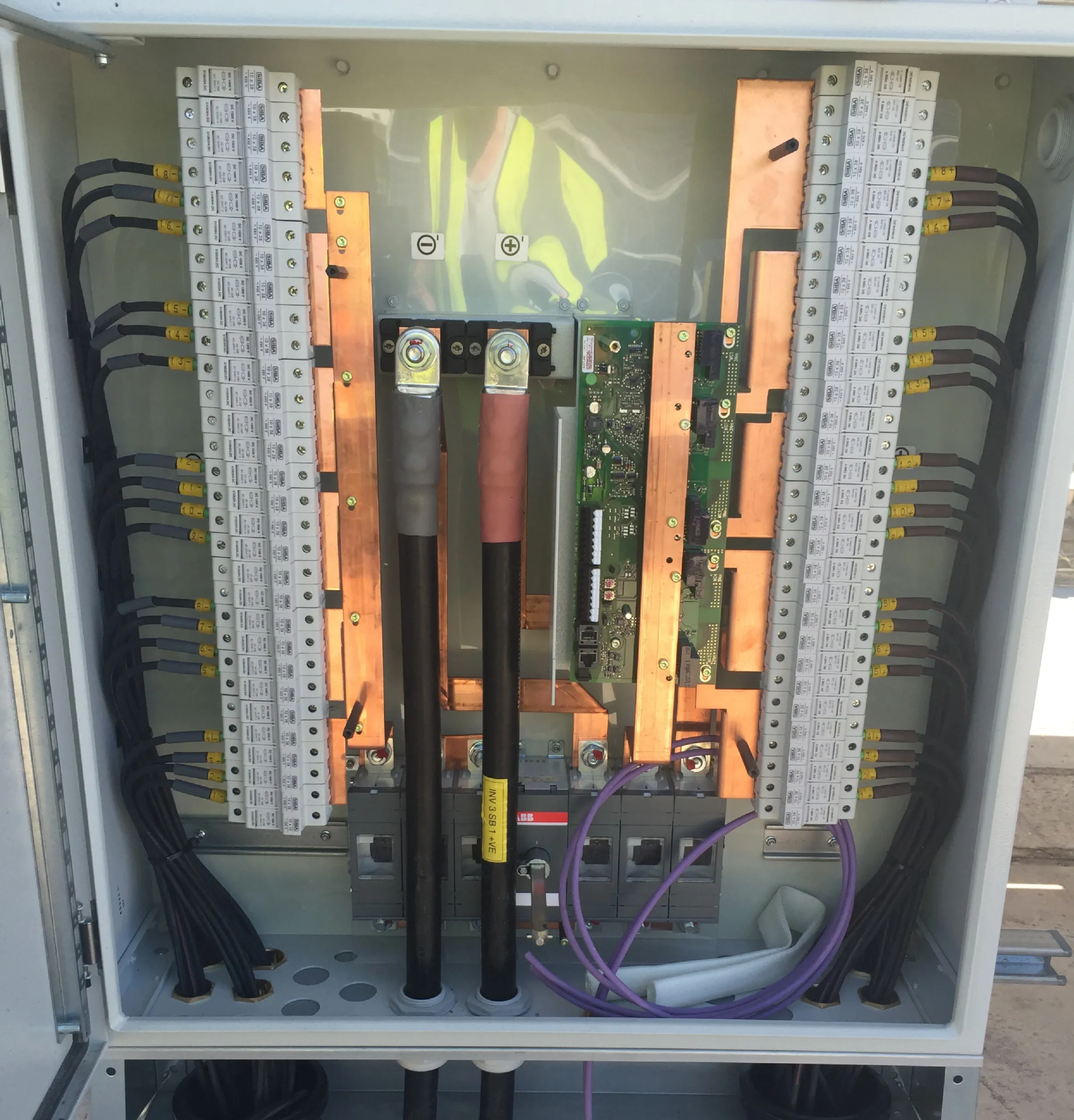

In larger installations, strings may be combined in string combiner boxes, from which larger conductors carry the combined current to the inverter. Figure 5 shows a PV string combiner box with an integral switch-disconnector. The rating of the switch-disconnector is based on the combined current of all the strings combined.
Figure 5: PV combiner box (identification of conductors to a previous version of BS 7671)

As an example, if a PV module was selected, as per Figure 4, and the designer had chosen two strings to be installed in parallel, the short-circuit maximum current (ISC MAX) is calculated as per Equation 2 using Formula 2 from earlier.
Equation 2: Determining design current
ISC MAX = No. of strings × ISC STC × 1.25
ISC MAX = 2 × 14 A × 1.25
ISC MAX = 35 A

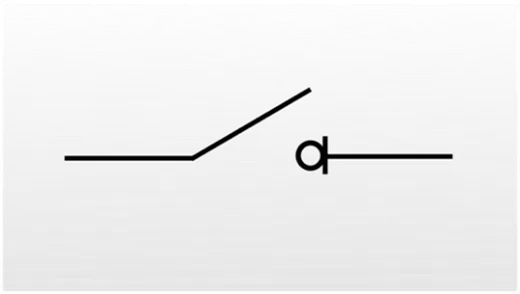

Figure 6: Switch-disconnector making, breaking and isolating symbol from BS EN IEC 60947-3:2021+A1:2025
BS EN IEC 60947-3 includes utilization categories that are specific to PV systems. These are summarized in Table 2. Devices marked DC-PV0 are not suitable for isolating an inverter where breaking capabilities are required - they are disconnectors rather than switch-disconnectors. This category is not rated for making or breaking current. DC-PV1 can be suitable where there are no parallel strings, while DC-PV2 is appropriate when multiple strings are connected in parallel.

From the example earlier, although based on a single string without any parallel connections, the voltage and current are as below:
UOC MAX = 480 V (10 × 40 V × 1.2)
ISC MAX = 17.5 A (1 × 14 A × 1.25)
The device shall be selected based on these values. The following section aids the designer in the correct configuration of the device.

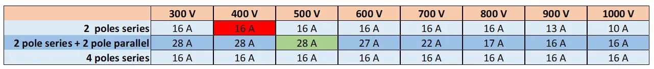

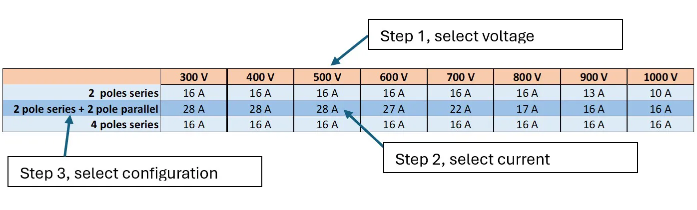

Figure 7 shows an example of the data that might be obtained from a manufacturer of a switch-disconnector. To determine the correct configuration, the steps are as follows:
  • Step 1: UOC MAX, as determined, is selected from the top row.
  • Step 2: the corresponding current from that column is selected that is greater than or equal to the ISC MAX.
  • Step 3: the corresponding configuration from the left-hand column is utilized.
It is important the installation instructions are referred to when configuring the device. These instructions can vary between manufacturers.
Figure 7: Hypothetical DC switch-disconnector ratings

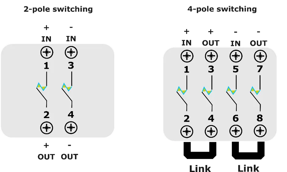

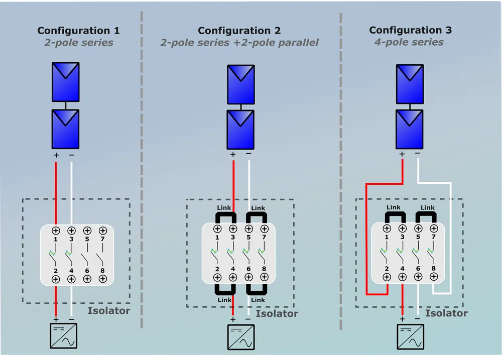

DC switch-disconnectors generally come in two-pole or four-pole configurations. The number of poles corresponds to the number of internal switching contacts within the switch-disconnector. A greater number of poles results in a larger arc gap and hence, a longer arc when breaking current, which in turn, allows for a higher breaking current rating with higher DC voltages.
Figure 8 illustrates an example of two-pole and four-pole switching. Figure 9 illustrates the configurations from the first column of Figure 7.
Figure 8 and  Figure 9 illustrate bridging links to enable certain configurations. These links are supplied by the manufacturer, although might require ordering separate to the switch-disconnector. It is important to follow manufacturers’ instructions on the use of the bridging links.
Figure 8: Two-pole vs four-pole switching
Figure 9: Switching configurations illustrated

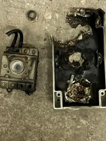

Using the data from Figure 7, the correct configuration for the device can be determined. The voltage determined in the previous section was 480 V so therefore, the 500 V column is selected. The current determined in the previous section was 17.5 A so therefore, the only suitable configuration based on this scenario is the ‘two-pole series + two-pole parallel’ configuration, which gives a breaking current of 28 A. Other configurations at this voltage are only suitable for 16 A, which is not sufficient. The correct value is highlighted in green in Figure 10.
If the STC, rather than the MAX values of current and voltage values were used, a two-pole configuration might appear sufficient, as highlighted in red within Figure 10.  However, this could cause the device to fail when switched under load, which could be catastrophic.
Figure 10: Selected configuration in green compared to STC in red

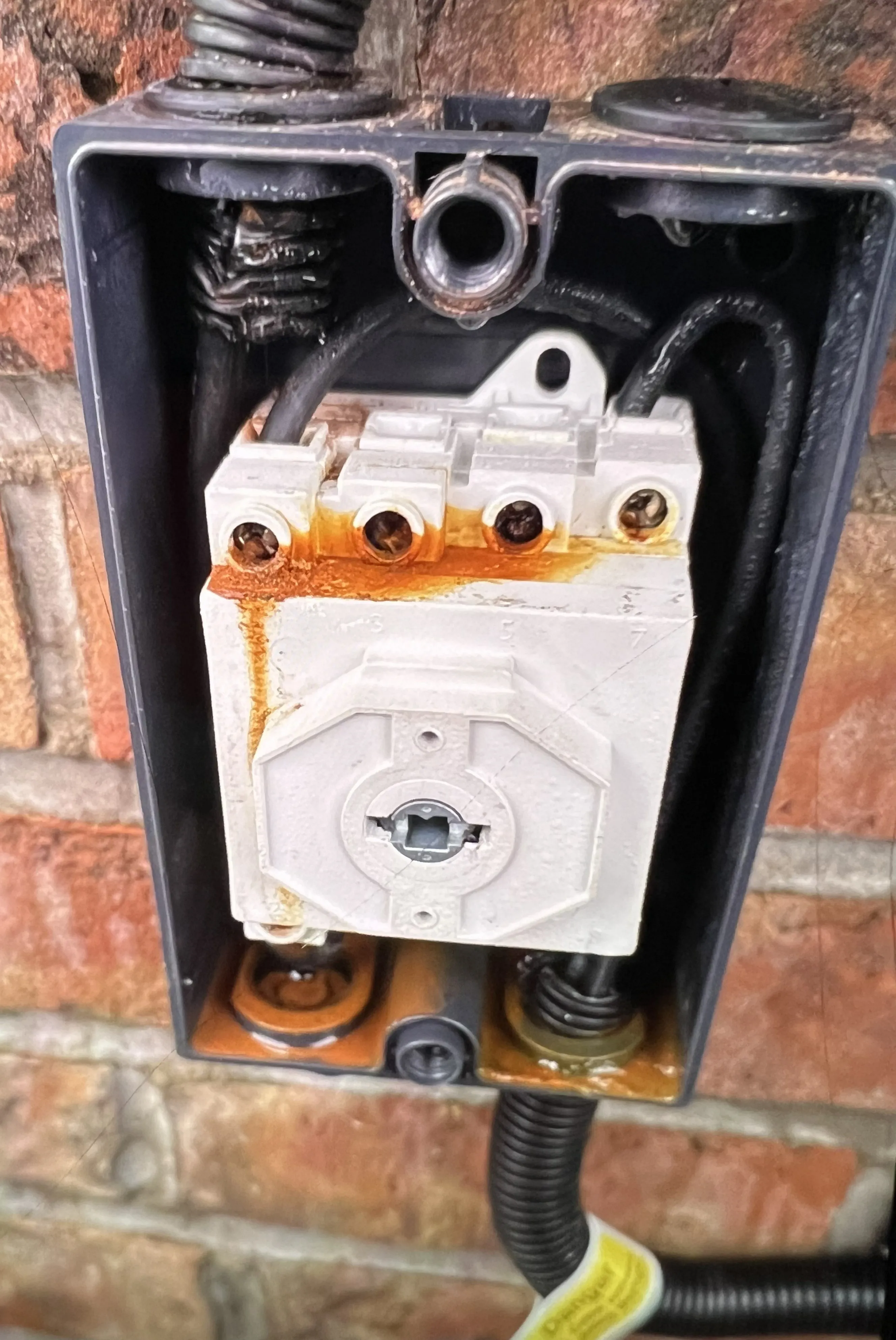

Figure 11: Incorrectly configured DC switch-disconnector that was switched under load

Other considerations that require attention include ensuring the device is suitable for the external influences that it will encounter.
For devices used outdoors, bottom entry glands might limit the chance of water ingress. Additionally, care should be taken to ensure the enclosure is not compromised by the fixings used; some external switch-disconnectors have fixing points located on the outside of the enclosure.
When mounting equipment outdoors, the potential increase in ambient temperature inside the enclosure should be considered. A switch-disconnector mounted on a south-facing wall will experience higher temperatures and increased UV exposure when placed in direct sunlight.
It is also important that, when using flexible conductors such as Class 5 conductors, the terminals are either suitable for this class of conductor or the conductors are properly treated. Some manufacturers might specify that fine-stranded conductors are to be fitted with a sleeve or ferrule.
Figure 12: DC switch-disconnector installed without consideration for the potential external influences

Lack of maintenance is considered a contributing factor to PV fires in the UK. When checking the DC switch-disconnector, the inspector must consider the possibility that the device was not correctly installed from the outset.
The following checks should form part of a minimum inspection (suitable safe working systems shall be in place):
  • the device is suitable and configured for the maximum voltage and current of the system/string
  • the device is suitably rated and installed for the potential external influences
  • the terminals are tightened to the correct torque
  • the conductors are suitable for the terminals (for example, treated with ferrules where required)
  • cycle the device off-load (with the inverter off, there is no current flow). Ensure there is no contact resistance when the contacts are closed.
