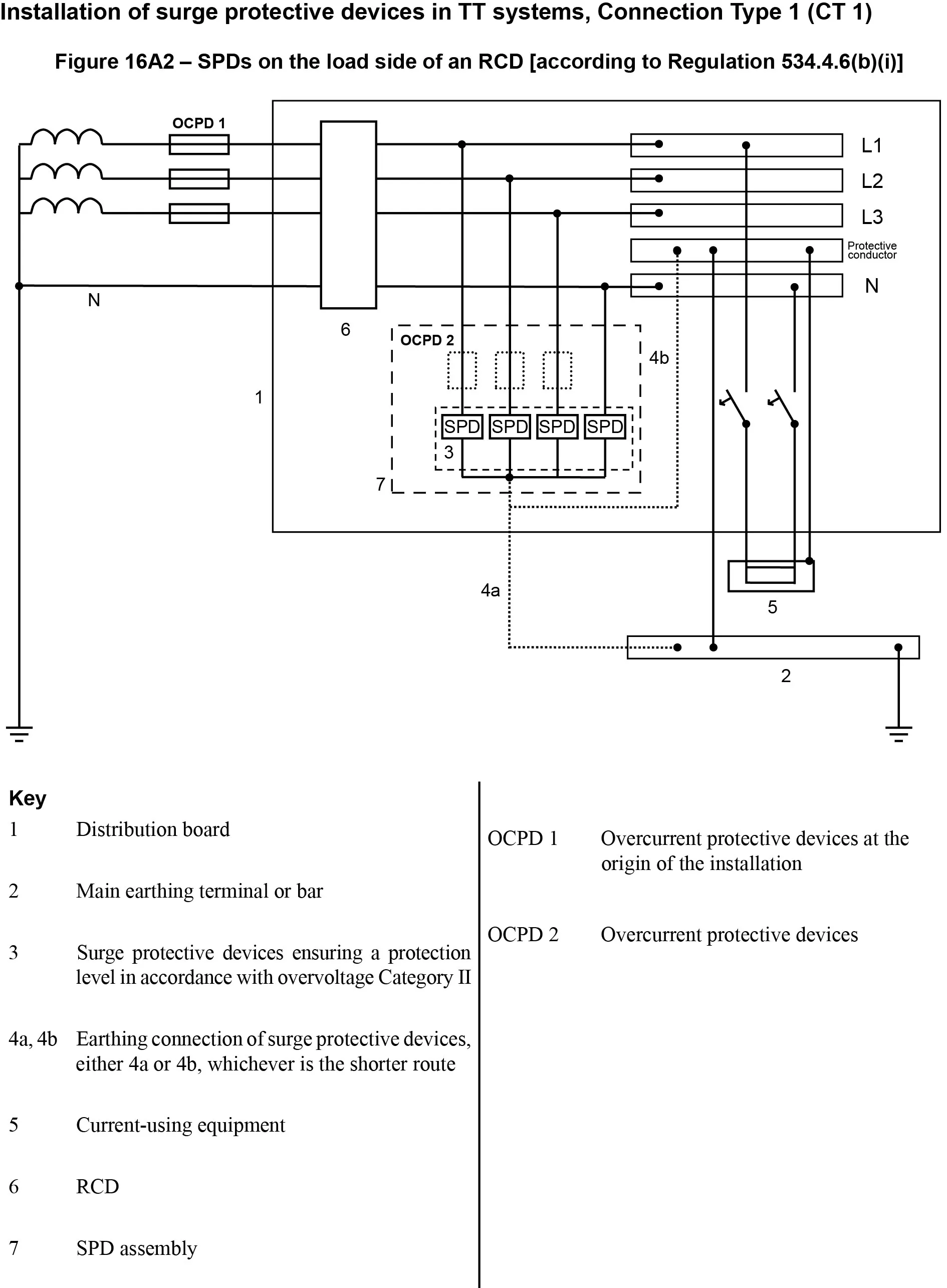

“534.4.5.2 Arrangement of SPDs with relation to overcurrent protection
In case of OCPD operation arising from SPD failure, the continuity of the supply to the equipment is unaffected. However, neither the installation nor the equipment is protected against possible further overvoltages (see Figure 534.6). In such an arrangement, the effective voltage protection level within the installation is increased due to the additional voltage drop at the external OCPD connected in series with the SPD.”
Appendix 16 of BS 7671:2018+A4:2026 provides information for devices for protection against overvoltage. Figure 16A2 shows OCPD 1 for protection of the SPD upstream of the RCD for a TT system. This could be the DNO fuse for a public supply network. OCPD 2 is shown as a dotted line to indicate this may not be required.

The guidance states that OCPD 2 shown in Figure 534.5 may be omitted and the DNO cut-out fuse (OCPD 1) can be used for short-circuit protection of the SPD where all of the following apply:
  • The SPD is in a household or similar installation.
  • The SPD is installed either inside a single-phase consumer unit (CU) conforming to BS EN (IEC) 61439-3, or inside an enclosure together with a switch-disconnector supplied as a composite unit conforming to BS EN (IEC) 60947-3. Both these products shall have a rated conditional short-circuit current of 16 kA. This conditional rating is qualified using a 100 A BS 88-3 (formerly BS 1361) fuse which also covers 60 A and 80 A fuse ratings. BS 1361 type II and BS 88-3 fuse-link key performance characteristics are identical, therefore, either is acceptable.
  • The SPD conforms to BS EN 61643-11.
  • The SPD manufacturer’s instructions state that OCPD 2 can be omitted and specify the required OCPD 1 characteristics.
  • The SPD does not require withdrawal of the DNO cut-out fuse for its replacement or maintenance.
This position is in line with the safety aspects of the DNO cut-out fuse not providing functional protection. However, it can be relied upon in extreme conditions to perform a short duration fault clearing role.
