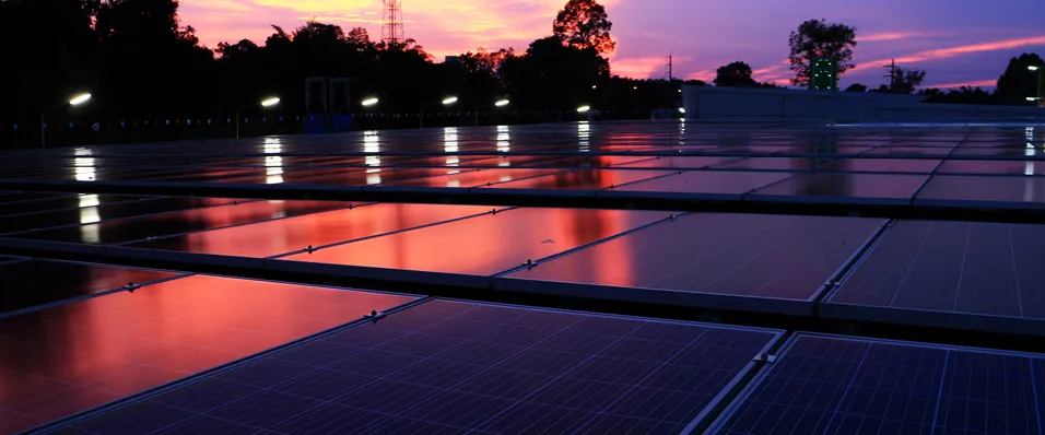

This new Chapter within BS 7671 covers energy efficiency measures, the interface with the smart grid, the management of electricity consumption, the management of renewable sources of electricity, and energy storage. This is a complex area and this article only mentions some of the many requirements concerning prosumers’ electrical installations (PEIs).
Chapter 82 provides additional requirements, measures and recommendations for the design, erection and verification of all types of low-voltage (LV) electrical installations. This includes the local production and/or storage of energy, in order to ensure compatibility with existing and future ways to deliver electrical energy to current-using equipment or to the public network by means of local sources. Such electrical installations are designated as PEIs.
Note: A new ‘foundation earthing’ requirement has been introduced into Chapter 54 to make arrangements for a suitable earth electrode provision for PEIs not connected to the LV public supply network.
The concept of the PEI has been developed to answer the needs of the end-user. For example, where a PEI has a storage capability, the user could take advantage of low demand to store energy when its price may be lower.
With active energy management, the end-user should be able to permanently monitor and control his or her own electricity consumption and production. The concept of the PEI has also been developed to take advantage of renewable sources of energy (such as solar photovoltaic (PV) and wind turbines) and energy storage.

A PEI is considered to be a low-voltage electrical installation connected (or not) to a public distribution network (the grid), able to operate with local power supplies (for example, PV panels or wind turbines), and/or with local storage units (for example, batteries). It monitors and controls the energy from the connected sources delivering it to current-using equipment (for example, motors, heating, lighting, and appliances such as washing machines, etc), and/or local storage units (for example, batteries), and/or the public distribution network.
There is a wide range of microgeneration technologies, including solar PV, wind turbines, small-scale hydro, and micro combined heat and power (CHP).
