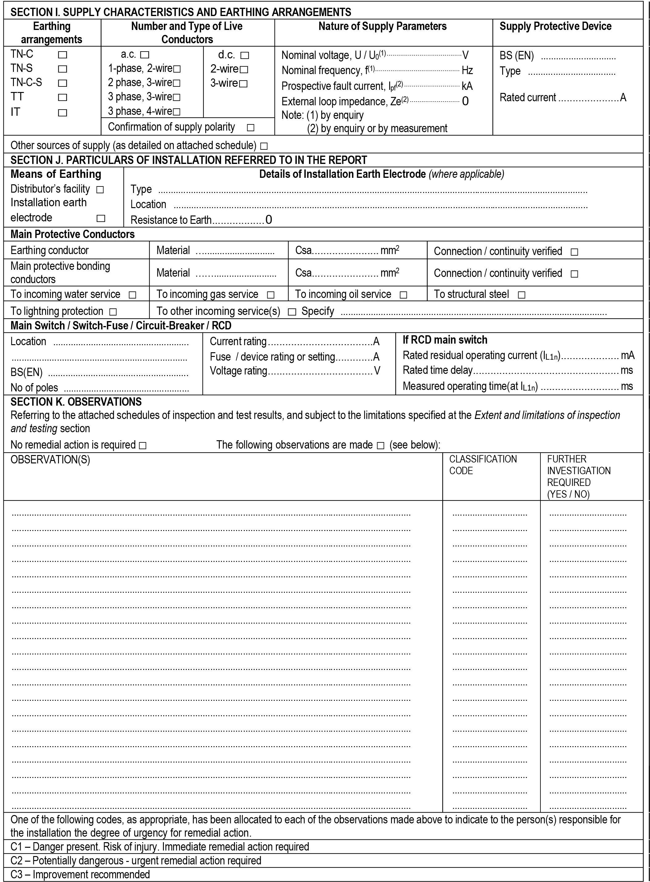

The name of the report changed from “periodic inspection report” to “electrical installation condition report” in BS 7671:2008+A1:2011. It was at this time that a change was made to include a separate column to record the FI classification code, along with another code (see Figure 1). At this time, only a C1 or C2 classification code resulted in an unsatisfactory outcome (see Figure 2).

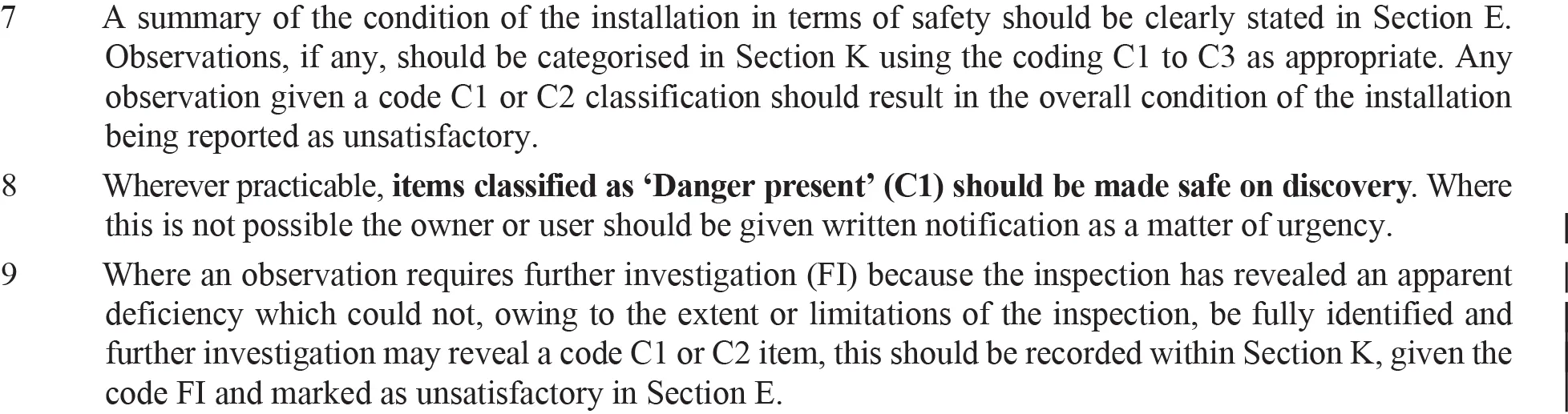

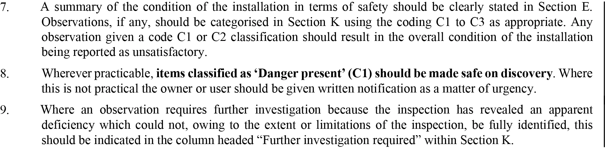

It is clear that there was confusion regarding the FI classification code at that time, because “note 9” of the notes for the person producing the report was amended.
The purpose was to clarify that only those observations attributed an FI classification code because the inspection had revealed an apparent deficiency which could not, owing to the extent or limitations of the inspection, be fully identified, and further investigation may reveal a C1 or C2 observation (see Figure 3).
Figure 1: Section K of EICR in BS 7671:2008+A1:2011
Figure 2: Notes for the person producing the report in BS 7671:2008+A1:2011
Figure 3: Notes for the person producing the report in BS 7671:2008+A3:2015

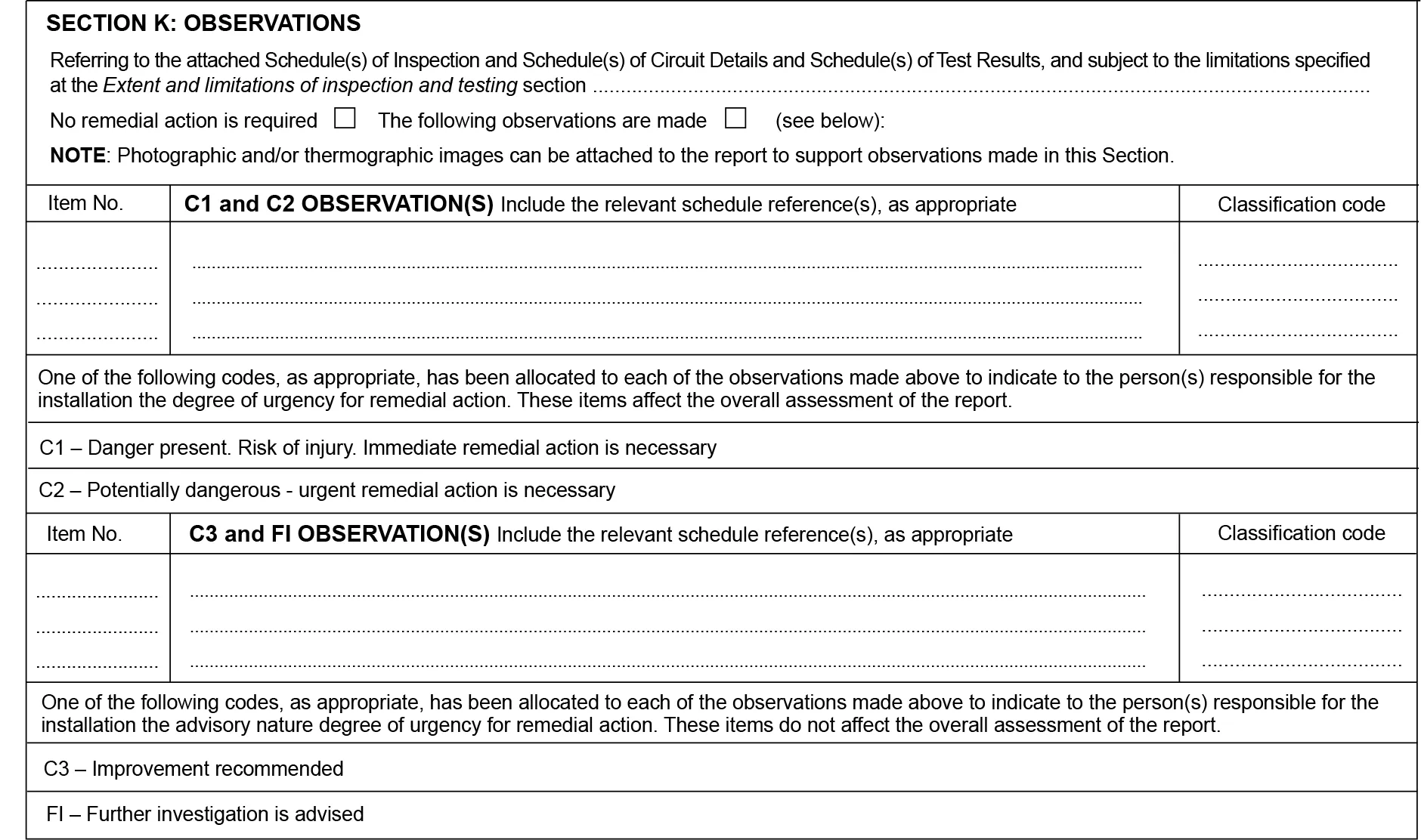

To make it clear that a C3 or FI classification code does not result in an unsatisfactory outcome, they have been decoupled from the C1 and C2 classifications codes, and a note has been added to explain this (see Figure 4). Previously, for an FI classification code, further investigation was required without delay. This has been changed to “further investigation is advised”.
This makes clear to the person(s) responsible for the installation, those observations which result in an unsatisfactory outcome and require remedial work, and those which are recommendations and advisory.
Figure 4: Section K of EICR in BS 7671:2018+A4:2026

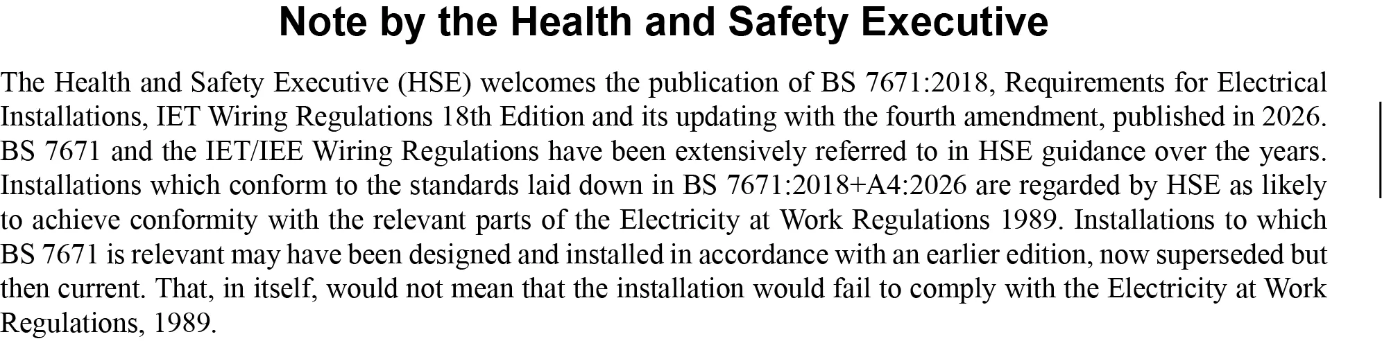

Gas Safe Register removed the code, “not to current standards (NCS)” in 2016. The reason NCS was removed, is to reflect the fact that just because the installation is not to current standards, does not necessarily mean it is unsafe. The client can be advised that the installation is not to current standards, but this should not be recorded on any warning notices, or safety-related paperwork or documentation. This is to ensure that the key safety messages are not detracted from. A similar statement is shown in the note by the Health and Safety Executive (HSE) in BS 7671:2018+A4:2026 (see Figure 5).
Figure 5: Note by the HSE in BS 7671:2018+A4:2026
