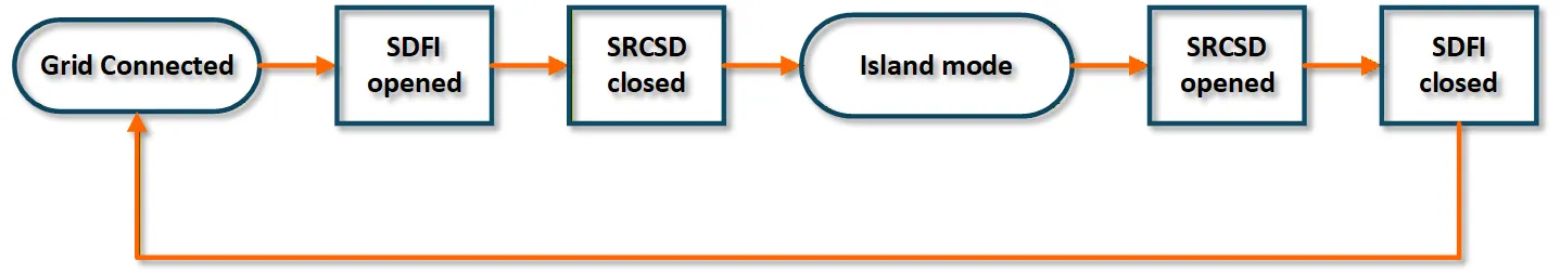

To connect and disconnect the SRC, a system referencing conductor switching device (SRCSD) is required. This device shall be capable of making and withstanding the current that can flow for the duration of a fault. The sequence of operation of the SRCSD should follow that shown in Figure 1. Operation without reference to the system earth is acceptable for a short duration, generally less than five seconds. This process may be controlled by an EEMS.
NOTE: A new standard was published in 2025 relating to SRCSDs: BS EN IEC 63445:2025 System referencing conductor switching device.
In order to allow a PEI to connect to, and subsequently be disconnected from, the grid, a switching device for islanding (SDFI) is required. This can be manually or automatically controlled and shall be interlocked with the SRCSD. The SDFI shall be suitable for isolation (Regulation 826.1.1.5 of BS 7671).
NOTE: A new standard was published in 2026 relating to SDFIs: BS EN IEC 63552:2026 Switching device for islanding (SDFI).
The SRCSD and SDFI shall be located so as to prevent unauthorized operation. This may be achieved by installing these within enclosures that require a key or a tool for access by competent persons.
Figure 1: Sequence of operation from grid-connected[1] mode to island mode and back again

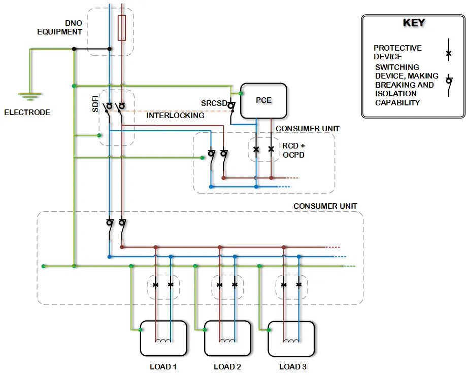

Figure 2 illustrates the possible locations of the SRCSD and SDFI.
Figure 2: Simple schematic depicting the possible location of switching devices
NOTE: The SDFI and SRCSD can be contained within a single item of equipment, such as a ‘gateway’.

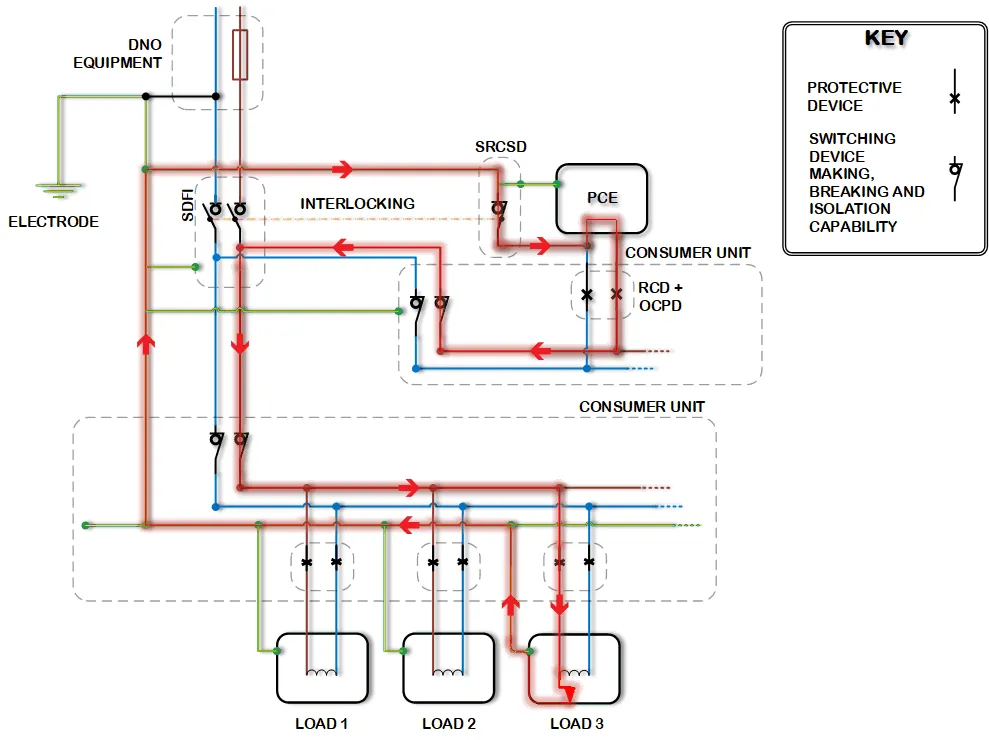

Location of RCDs providing fault protection for island mode operation
Where a conventional RCD, such as a residual current operated circuit-breakers with integral overcurrent protection (RCCB) or residual current operated circuit-breakers with integral overcurrent protection (RCBO), is used for fault protection to achieve the required disconnection times during island mode operation, it is important that the device is located in a suitable position within the installation.
For the RCD to detect a residual current under fault conditions, it must be installed at the load side of the point of system referencing.
Figure 3 illustrates the earth fault loop path for a fault on load 3.
Figure 3: Earth fault loop impedance path for a fault on load 3 in island mode operation

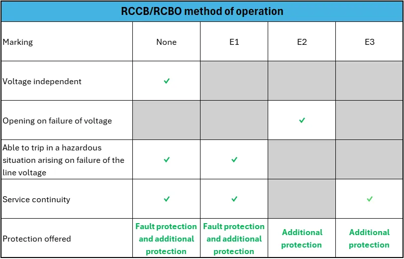

Classification of RCDs for island mode operation
RCCBs conforming to BS EN 61008-1 and RCBOs to BS EN 61009-1 are classified based on their operating behaviour with or without voltage, and their response in hazardous conditions.
Table 1, is based on the information presented in Section 4.1 of Table Z1 of BS EN 61008-1:2012+A12:2017 and BS EN 61009-1:2012+A13:2021; it categorizes RCDs by their voltage dependence.
  • Voltage-independent RCDs (unmarked) operate purely on residual current and will trip even if no supply voltage is present
  • Voltage-dependent RCDs are marked with specific classifications:
    • E1: trips in hazardous situations even if supply voltage fails
    • E2: trips upon loss of voltage
    • E3: does not trip if the voltage falls outside its rated range.
Table 1: RCDs categorized by their voltage dependence
As E2 and E3 marked devices offer additional protection only, these are not generally suitable for providing fault protection.
For further information on E markings on RCDs, BEAMA has produced a technical bulletin: Guide to Residual Current Device (RCD) E Marking.
