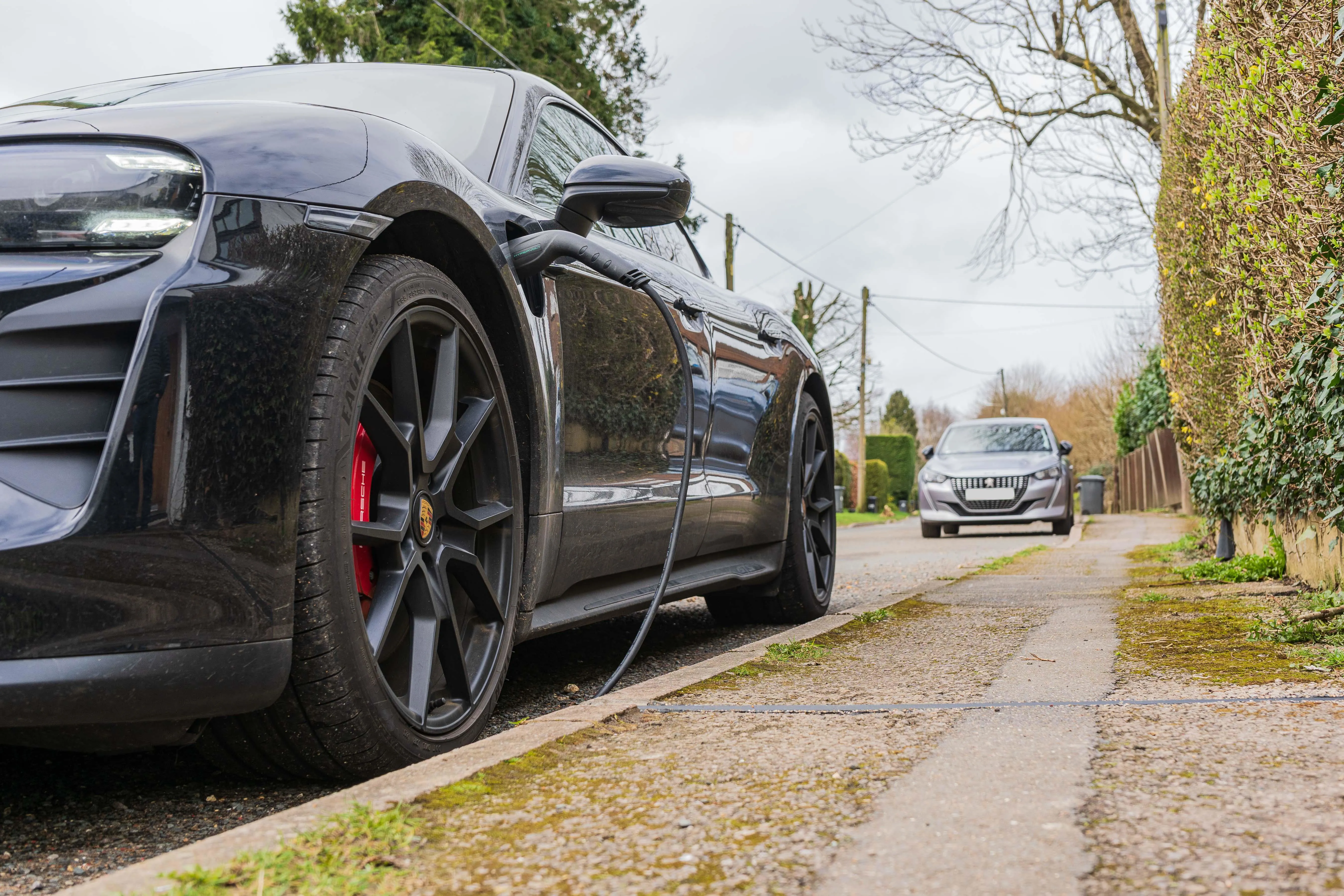

NET zero is in full swing and electric vehicle (EV) sales are rising fast. Petrol forecourts have been used for years to fuel vehicles under safe, heavily regulated safety standards, but because of the way electricity is distributed and priced in the UK, alternative methods are being sought.
This means more people will want to have their own charger at home. This is a simple thing to install in most cases if you have off-street parking. However, if you do not have off-street parking then it becomes a challenge.
To help as many people as possible charge at home on their own tariffs, many local authorities, with support from the government, are proposing to allow a section of the pavement to be cut out and a channelling system to be installed, enabling the homeowner to charge their vehicle from their own property, across the pavement.
This is designed to solve the obvious trip hazard created by a charging cable over the pavement. However, trip hazards are not the only hazard to consider here. This article will examine the other considerations that need to be made.

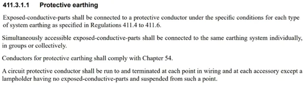

Simultaneous contact assessment
Section 3.5 of the IET Code of Practice for Electric Vehicle Charging Equipment Installation, 5th Edition provides information about simultaneous contact and how to assess this.
It is important that any exposed-conductive-part surfaces that are connected to different earthing systems remain separated, to prevent simultaneous contact of a person between them. This is a fundamental regulation as stated in Regulation 411.3.1.1 of BS 7671:2018+A4:2026.
Figure 1: Excerpt from BS 7671:2018+A4:2026, Regulation 411.3.1.1
This regulation protects contact from hand-to-hand for several reasons, as listed below. The simultaneous contact assessment is to ascertain whether it is possible to make contact between the exposed-conductive-parts of the charging equipment/vehicle being charged and any exposed-conductive-parts or extraneous-conductive-parts connected to any other earthing system. This is to prevent electric shock caused by hand-to-hand contact. Examples of causes are:

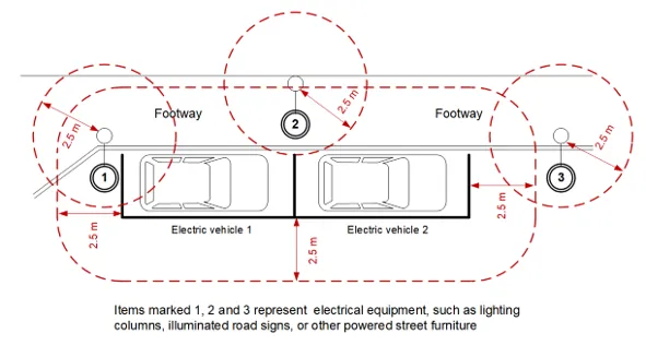

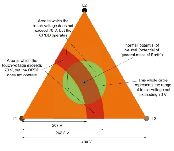

Open PEN faults are not the only thing to consider. For these reasons, the IET Code of Practice for Electric Vehicle Charging Equipment Installation recommends a minimum distance of 2.5 m between simultaneously accessible earthing arrangements.
Therefore, if installing a cross-pavement charging solution, the usual simultaneous contact assessment is required. It is also worth noting that some street furniture may be Class II rather than Class I. An example of this is certain ticket machines.
For a house with a TT earthing arrangement next to a house with a TN-C-S earthing arrangement, it may not be possible to install these cross-pavement solutions safely.
In the example shown in Figure 2 below, the following equipment with exposed-conductive-parts would be considered simultaneously accessible according to BS 7671:2018+A4:2026, and is required to be connected to the same earthing system:
- Electric vehicle 1
- Electric vehicle 2
- Metal lighting column or illuminated road sign marked 1
- Metal lighting column or illuminated road sign marked 2
- Metal lighting column or illuminated road sign marked 3.
Typically, only the local distribution system operator (DSO) will know whether supplies for street furniture and lighting are connected to the same earthing system as the supply to the premises in which the electric vehicle supply equipment (EVSE) is to be installed.
The Highway Electrical Association Guidance Note Electric Vehicle Charge Point Touch Potential assists those carrying out simultaneous contact assessments for on-street charging.
Figure 2: A plan of a simultaneous contact assessment

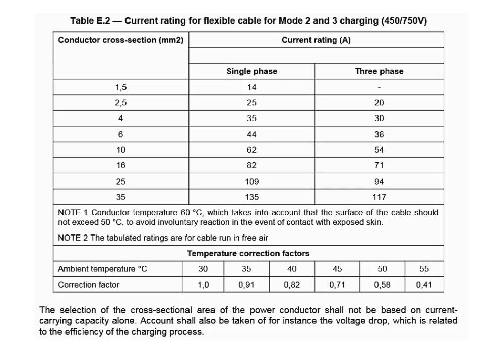

The current carrying capacity of a cable is dependent on the insulation’s temperature being maintained below its safe operating temperature. Any excessive temperatures beyond the safe operating temperature will drastically shorten the life of the cable. Increased terminal temperatures at connections can eventually cause danger in the form of electric shock or fire.
The cable used for EV charging leads must conform to BS EN 50620:2017+A2:2024. BS 7671:2018+A4:2026 does not contain correction factors for cables installed in shallow depth metallic channels in tarmac or any other pavement surface.
The BS EN 50620:2017+A2:2024 standard contains some information for current carrying capacity. Table 2 includes information for Mode 2 and 3 charging from Table E.2 of BS EN 50620:2017+A2:2024. Most of these schemes would only be authorized by the local authority or estate dutyholder for Mode 3 charging.
Table 2: Table E.2 from BS EN 50620:2017+A2:2024
The table provides correction factors corresponding to various ambient temperatures. In direct sunlight, tarmac can reach temperatures of 40 to 50 °C during hot and sunny days, possible exceeding 50 °C on south-facing gradients[3]. By applying correction factors based on these temperatures, it has a dramatic effect on the current rating of the cable.
This is only on hot sunny days and in winter the effects of this will be much less dramatic. Caravans and marine hook ups also have similar cables used in direct sunlight with little ill effect. However, an EV will be drawing current for long periods of time and although most charging would ideally be taking place overnight, some people may need to charge during the day if they can get a space outside their home, or if their electrical tariff off-peak hours are during the day.
More research is required into the effects of the cable temperature when surrounded by heated pavement surfaces in a shallow metallic channel due to direct sunlight.
Table 3 and Table 4 show the suitability of cross-sectional area (CSA) of cables to BS EN 50620 for single-phase and three-phase charging, considering a potential onerous correction factor of 0.81 to take into account the confinement of the shallow duct plus the temperature (see note 3).

| Temperature correction factor (NOTE 2) | 1.00 | 0.91 | 0.82 | 0.71 | 0.58 | 0.41 | |
| Correction factor for cable in a gulley (NOTE 3) | 0.81 | 0.81 | 0.81 | 0.81 | 0.81 | 0.81 | |
NOTES to Table 4:
(1) At ambient temperature of 30 °C.
(2) Taken from Table E.2 of BS EN 50260:2017+A2:2024.
(3) Estimated from the ratio of current-carrying capacities between Reference Method B* and Reference Method C* in Table 4D5 of BS 7671:2018+A4:2026.

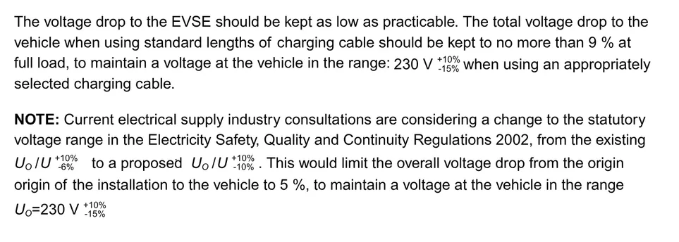

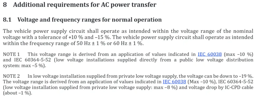

Voltage drop
Voltage drop is the function of current and impedance. An increase in cable length or an increase in current will result in an increased voltage drop. The EV charging point supply cable will have this calculated by the installer to ensure the cable size is adequate to deliver the required voltage. The installer would not have allowed for the charging lead itself. It is noted at the bottom of Table E.2 of BS EN 50620:2017+A2:2024 that voltage drop needs to be taken into consideration.
BS EN ISO 17409:2020 Electrically propelled road vehicles. Conductive power transfer. Safety requirements states that:
Figure 3: Excerpt from BS EN ISO 17409:2020

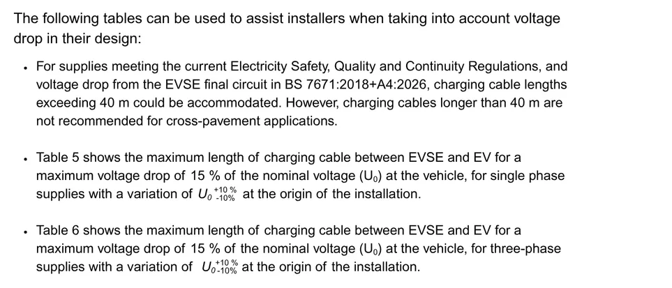

Table 5: Maximum length of single-phase charging cable to BS EN 50620 from EVSE to EV based on total voltage drop assuming a maximum supply voltage variation of U0-10 %.
| Charging cable CSA (mm2) | Charging power (kW) | Adjusted nominal charging current (A) (NOTE 1) |
Cable voltage drop (mV/A/m) (NOTE 2) |
Maximum length (m) of charging cable from EVSE to EV for a voltage drop between the origin of the consumer’s installation and the EVSE at the stated load current of | ||||
| 0.5 % | 1.0 % | 2.0 % | 3.0 % | 4.0 % | ||||
| 2.5 | 2.4 | 11.16 | 19 | (NOTE 3) | (NOTE 3) | 32.5 | 21.6 | 10.8 |
| 4.0 | 2.4 | 11.16 | 12 | (NOTE 3) | (NOTE 3) | (NOTE 3) | 34.3 | 17.1 |
| 6.0 | 7.36 | 34.22 | 7.8 | 38.7 | 34.4 | 25.8 | 17.2 | 8.6 |
| 10.0 | 7.36 | 34.22 | 4.6 | (NOTE 3) | (NOTE 3) | (NOTE 3) | 29.2 | 14.6 |
| 16.0 | 7.36 | 34.22 | 2.9 | (NOTE 3) | (NOTE 3) | (NOTE 3) | (NOTE 3) | 23.1 |
NOTES to Table 5:
(1) Takes into account the increase in effective load current of constant power loads at maximum voltage drop, in comparison with the effective load current of a linear load at maximum supply voltage.
(2) Voltage drop at 60 °C taken from Tables 4F1B and 4F3B of BS 7671:2018+A4:2026.
(3) Maximum length of cable due to voltage-drop exceeds 40 m. Charging cables longer than 40 m are not recommended.
Table 6: Maximum length of three-phase charging cable to BS EN 50620 from EVSE to EV based on total voltage drop assuming a minimum supply voltage U-10 %
| 2.5 | 11 | 16.98 | 16 | (NOTE 3) | (NOTE 3) | (NOTE 3) | 29.4 | 14.7 |
| 4.0 | 11 | 16.98 | 10 | (NOTE 3) | (NOTE 3) | (NOTE 3) | (NOTE 3) | 23.5 |
| 6.0 | 22 | 33.96 | 6.7 | (NOTE 3) | (NOTE 3) | (NOTE 3) | 35.1 | 17.5 |
| 10.0 | 22 | 33.96 | 4.0 | (NOTE 3) | (NOTE 3) | (NOTE 3) | (NOTE 3) | 29.4 |
| 16.0 | 22 | 33.96 | 2.5 | (NOTE 3) | (NOTE 3) | (NOTE 3) | (NOTE 3) | (NOTE 3) |
NOTES to Table 6:
Open Pen Detection Devices (OPDDs)
OPDDs are only recognized in BS 7671:2018+A4:2026 for disconnection of an EV due to open PEN faults.
OPDDs have sometimes been cited to mitigate against simultaneous contact. This is not true. IET 01:2024 is currently the only standard for OPDDs.
An OPDD to IET 01:2024 is not tested for its ability to mitigate against the full range of situations that may occur through simultaneous contact and not complying with Regulation 411.3.1.1 of BS 7671:2018+A4:2026. The scope of IET 01:2024 states that:
“The functionality of OPDDs is intended to protect persons and livestock from the resulting issues relating to a continuity fault in the PEN conductor, such as, electric shock and thermal effects when employed in 230 V AC single-phase, 230/400 V AC three-phase and 230/460 V AC split-phase supply systems.”
The full range of potential implications from simultaneous contact between different earthing arrangements have therefore not been considered. This is to be expected, as Regulation 411.3.1.1 of BS 7671:2018+A4:2026 requires simultaneously accessible exposed-conductive-parts to be connected to the same earthing system (see above).
M1a and M1b are methods of operation according to IET 01:2024 and both monitor line to neutral voltage. On a three-phase distribution main (most common), the neutral voltage with respect to Earth on the consumer’s side of a broken PEN will depend on the sum of all resistances to Earth such as extraneous-conductive- parts, distributor’s electrodes and consumer electrodes, and the unbalance of loads on the distribution main, across all the installations on the consumer side of a PEN fault.
The larger the imbalance, the larger the touch voltage. It is important to note that whilst OPDDs may help control the risk of a touch voltage rising higher than 70 V because of an open PEN fault, there are conditions in which the touch voltage exceeds 70 V and the OPDD does not operate. This risk can be reduced by the adoption of method M3 in conjunction with method M1a.
The problem with method M1a is that it does not align with thresholds in Energy Networks Association (ENA) Engineering Recommendations G98 and G99 and therefore, is considered incompatible with vehicle to home and vehicle to grid applications. Whilst M1b allows more range of voltage, the possibility of having a touch voltage >70 V but not operating is intolerable, so must be used in conjunction with protection method M3.

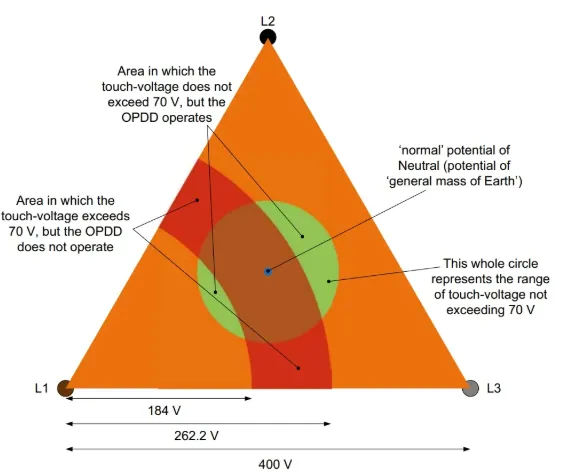

Figures 4 and 5 illustrate that there are possible areas of the diagram where the neutral to Earth touch voltage may rise above 70 V and the OPDD will not operate. It should also be considered that, in a real open PEN fault, the neutral voltage is constantly changing as the balance of loads on the phases changes, and therefore, it is likely that the fault would be detected by methods M1a or M1b at some point.
It is also important to note that under some rare fault conditions with extreme power factor or harmonics, it is theoretically possible for the neutral to Earth voltage to rise to nominal voltage level (U0).
Figure 4: Excerpt from IET 01:2024 shows a phasor-space diagram comparing the thresholds of line to neutral voltage for method of operation M1a and of areas where the voltage may exceed 70 V but the OPDD does not operate
Figure 5: Excerpt from IET 01:2024 shows a phasor-space diagram comparing the thresholds for line to neutral voltage for method of operation M1b with a touch voltage of 70 V
Method M3 is a way of mitigating against the potential blind spots of methods M1a and M1b. This does not avoid the other issues associated with simultaneous contact of different earthing systems.
Whilst having type M1b and M3 methods as per IET 01:2024 is certainly “a nice to have”, the M3 part will only operate once a person is already receiving a contact shock. It is important to understand that OPDDs to IET 01:2024 are detection devices that reduce the probability of a dangerous shock, although cannot fully protect from it in all scenarios.
So, whilst these detection devices reduce the probability of a dangerous situation, they are not the same as a protective device that we are used to such as residual current devices (RCDs). An OPDD has only been considered for a certain scenario and not for simultaneous contact between different earthing systems.
