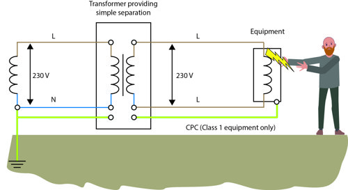

Regulation Group 413 details the actual requirements but the salient aspect is that it utilizes insulation of live parts as the basic protective measure in common with other provisions, however, the fault protection does not rely on automatic disconnection but is “provided by simple separation of the separated circuit from other circuits and from Earth.” Figure 1 illustrates the concept.
Figure 1 Example of electrical separation for one item of current using equipment (Regulation 413.1.2). (Image taken from the IET Guide to Temporary Electrical Systems, 2nd Edition, Figure 5.19.).
With this, protection from the risk of electric shock is provided by the lack of connection of the secondary side of the transformer with the general mass of Earth and other electrical circuits. If a user is simultaneously in contact with the mass of Earth and a faulty item of equipment, as shown in Figure 1, no electric shock to Earth will occur as there is no path for current to flow back to the secondary winding.
The second key part is in Regulation 413.3.2 which requires that “The separated circuit shall be supplied through a source with at least simple separation, and the voltage of the separated circuit shall not exceed 500 V.” What is not required, despite popular thought, is the use of an isolating transformer.

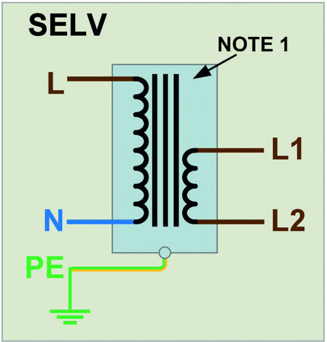

Isolation transformers are required in certain applications where this could be an issue. An example is a separated extra-low voltage source (SELV), such as that required for an extra-low voltage lighting installation (Part 715). Here, the transformer must be a safety isolating transformer complying with BS EN 61558-2-6.
Such a transformer is illustrated in Figure 2. Note that a transformer providing isolation is depicted with more vertical bars between the primary and secondary, compared to a single line as shown in the transformer in Figure 1.
Figure 2 Safety isolating transformer providing separated extra-low voltage. Note 1 on the diagram states that the transformer should comply with BS EN 61558-2-6 or BS EN 61558-2-8. Image taken from IET Guidance Note 5: Protection Against Electric Shock, Figure 7.2.).

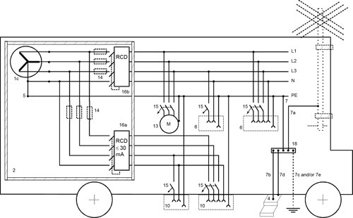

With this method, there is no electrical connection between the supply and the separated circuit. This is illustrated in Figure 3, where simple separation has been used to provide electrical separation between one electrical system and another.
Note that there is no electrical connection between primary and secondary and ‘simple separation’ is defined in BS 7671 Part 2 as “Separation between circuits or between a circuit and Earth by means of basic insulation.”
Figure 3 Example of simple separation on the supply to a mobile unit. (Image taken from BS 7671:2018+A2:2022+A3:2024, Figure 717.1.).
The advantage with this is that it is possible to recreate a different earthing arrangement in an installation. For example, a TN-C-S arrangement could be used to supply a transformer with a TN-S or IT output topology.

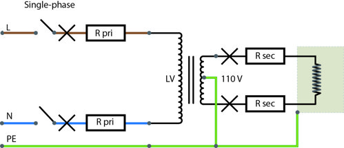

This has a subtlety of its own. Isolation as a technique may not necessarily require separation from Earth – examples include reduced low voltage (110 V) and PELV systems - where the transformer provides isolation, but the earthing arrangements are connected together on both primary and secondary sides.
Figure 4 shows an example of a reduced-low voltage isolating transformer which illustrates the concept.
Figure 4 Reduced low voltage system. (Image taken from IET Guidance Note 5: Protection Against Electric Shock, Figure 4.8.).
