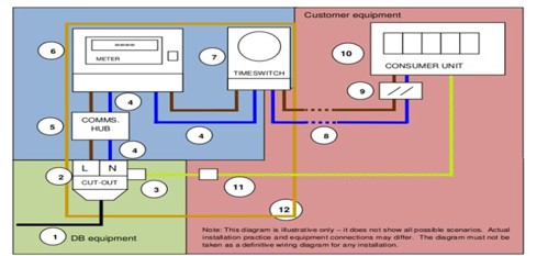

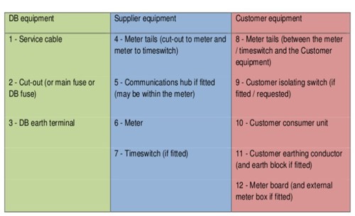

Figure 1 Diagram of equipment responsibility4. Image provided with kind permission of the Retail Energy Code.
Figure 2 Diagram of equipment responsibility descriptors5. Image provided with kind permission of the Retail Energy Code.

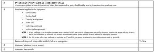

Additionally, inspectors undertaking the periodic inspection and testing of an electrical installation are required to carry out a visual inspection of the external condition of the distributor’s and supplier’s intake equipment. The model form in Appendix 6 of BS 7671:2018+A2:2022+A3:2024 for periodic inspection and testing refers to this (see Figure 3).
Figure 3 Intake equipment visual inspection12.
On the inspection schedule, item 1.1 is the only portion of the schedule which permits the inspector to record an X as opposed to a classification code. Recording an X does not affect the outcome of the report, although this is not the case where access to live parts has been found.
Where an inadequacy has been observed, the person ordering the report should be informed immediately and in writing. The person ordering the report should then notify the responsible party, i.e., the distributor or supplier.

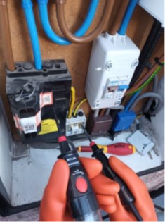

Surface voltage found on plastic cut-outs
Phenolic materials used in black plastic cut-outs (see Figure 4) between 1967 and 1992 have been known to become conductive and/or produce excessive heat. To create phenolic materials, phenolic resin was permeated into glass fibre, cotton or paper pulp, and bound via a combination of heat and pressure.
Overheating can cause materials to break down and leave behind an ash-like residue, which can conduct when wet. Conductive pathways on the surface of insulators, termed ‘tracking’, can lead to short-circuits and fires.
Figure 4 Cut-out made from phenolic material19. Image provided with kind permission of the Retail Energy Code.
The risk of surface voltages appearing on plastic cut-outs poses a risk of electric shock; therefore, STIRG provides meter operatives with specific guidance around initially testing via a direct contact voltage indicator, followed by supplementary tests with a two-pole voltage indicator where a sustained voltage is present (see Figure 5).
Figure 5 Testing the cut-out for the presence of surface for voltage20. Image provided with kind permission of the Retail Energy Code.

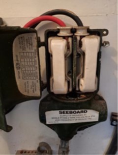

Older distributor’s equipment may contain asbestos, such as flash guards within rewireable fuse carriers (see Figure 7). When disturbed, these extremely friable, loosely bound materials permit the release of fibres into the atmosphere.
Figure 7 Fuse carriers containing ACMs22.
DNOs have specific procedures for the replacement of asbestos containing materials; therefore, the cut-out fuse should not be withdrawn, and the DNO should be notified.

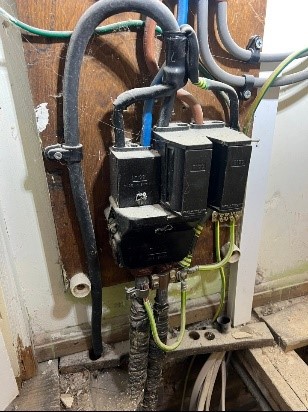

The identification of the correct cut-out fuse is essential prior to withdrawal; for example, ground floor flats have been known to contain two cut-out fuses where the flat above is supplied at the same intake position (see Figure 8). This is not only a safety concern but may also have financial consequences due to loss of supply, so it is important to check.
Figure 8 Intake position with two cut-out fuses.
