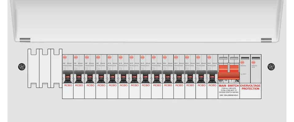

Overvoltage protection could be installed in an existing consumer unit where appropriate physical space is available. Alternatively, where insufficient space is available, overvoltage protection could be installed in an external enclosure adjacent to the existing consumer unit.
Many home insurance providers cover lightning strokes but surges caused by equipment or faults can vary depending on the cause of the surge, so, it is important to check your home insurance policy.
For requirements when selecting and installing SPDs for an electrical installation, where required, see Section 534 and Appendix 16 of BS 7671:2018+A2:2022.
Figure 2 Surge protected consumber unit (Image credit: Electrium)
