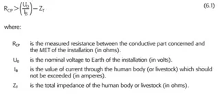

It should be verified if parts are deemed to be extraneous-conductive-parts before there may be a requirement to connect them to the MET. The best way to determine whether a conductive part is likely to introduce Earth potential is visual inspection. If it is not possible to determine by visual inspection alone, then a measurement of resistance to Earth can be obtained to determine if the conductive part in question is to be considered an extraneous-conductive-part. Where the measured resistance value between the conductive part concerned and the MET of the installation exceeds the requirements calculated by the equation below, Figure 6.1 taken from IET Guidance Note 8 Earthing and Bonding, the conductive part concerned need not be considered an extraneous-conductive-part as defined in BS 7671:2018. However, the designer must consider the stability of the resistance of the conductive part throughout the lifetime of the installation.
Once the test has been carried out and a value has been obtained, a calculation can be performed to determine if the resistance is low enough for the conductive part to be considered as an extraneous-conductive-part with respect to the safe level of current flow deemed acceptable to the designer.
The values of IB and ZT are taken from BS IEC 60479-1:2018 Effects of current on human beings and livestock. The type of current is 50/60 Hz alternating current.

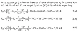

Table 2 of BS IEC 60479-1:2018, indicates values of total body resistance for hand to hand in wet conditions.
For the purposes of this example, the value of ZT selected is 1000 Ω.
Secondly, the designer must select the acceptable value of IB;
  • 0.5 mA –  The threshold of perception
  • 10 mA –- The threshold of let-go; or
  • 30 mA – a current which can cause effects such as the following, depending on the time which automatic disconnection occurs. Where automatic disconnection occurs within 300 ms (for example, by non-delay RCD with IΔn not exceeding 30 mA): Perception and involuntary muscular contractions, but usually no harmful electrical physiological effects. Longer disconnection time, up to 5 seconds: Involuntary muscular contractions, difficulty in breathing, reversible disturbances of heart function and immobilization, but usually no organic damage.
Looking at the examples below with various values of IB taken from IET Guidance Note 8, if the designer was to select 0.5 mA as a safe level of current through the human body and the measured resistance between the conductive part and the MET is above 459 kΩ, then it need not be considered an extraneous-conductive part, therefore would not require connecting to the main earthing terminal.

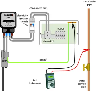

Testing and verification
A resistance test can be carried out between the conductive part in question and the MET. This is described in IET Guidance Note 8, Clause 6.1 and shown in Figure 1.0 below. The test needs to be carried out with a continuity tester with a voltage range of between 4 and 24 volts and with a test current of 200 mA. The test should be carried out between the MET and the conductive part in question.

The first problem is that the test can only be carried out when the other installations, not forming part of the electrical installation, are complete which means it will not always be possible to determine until the later stages of a project.
Another problem would be that any class 1 electrical equipment connected to the pipework such as a boiler, motorised valve, or pump would create a conductive path to the MET which could indicate a low reading.
In most cases, for example at the design stage, the installation will not yet have been built. In which case, the designer will have to consider both scenarios with and without the protective bonding connected. The prudent option would be to install the protective bonding conductors at first-fix stage as it is likely to be more difficult and expensive to do at a later stage. It would also likely involve damage to the building fabric or be required to be installed surface mounted, which would not be desirable for most clients.
