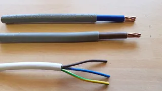

Are meter tails double insulated?
Technically no, because meter tails are not a protective measure in the installation designed to prevent the user from the risk of electric shock, like automatic disconnection, or electrical separation. More correctly such tails should be referred to as ‘insulated and sheathed’ cables, just as flat twin-and-earth or H07-RN-F flexible cables are.
However, it is evident that having two layers of insulation would appear to fulfil the requirements for both basic and fault protection, and this is noted in Regulation 412.2.4:
412.2.4 Wiring systems
412.2.4.1 Wiring systems installed in accordance with Chapter 52 are considered to meet the requirements of Regulation 412.2 if:
i. the rated voltage of the cable(s) is not less than the nominal voltage of the system and at least 300/500 V, and
ii. adequate mechanical protection of the basic insulation is provided by one or more of the following:
a. The non-metallic sheath of the cable
b. Non-metallic trunking or ducting complying with the BS EN 50085 series of standards, or non-metallic conduit complying with the BS EN 61386 series of standards.
So, for meter tails or other insulated and sheathed cables, the basic insulation over the conductor and the non-metallic sheath are deemed to comply with the requirements for both basic and fault protection in Regulation 412.2 and hence don’t need to be installed in containment (unless required for mechanical protection). What this also means is that removal of the outer sheath to enable the colour of the core to be identified outside of a wiring accessory (e.g. a meter or service block) should not be done, as the cable will have been reduced to having basic insulation only. The IET On-Site Guide has more information on meter tails in Section 2.2.3.
By the same rationale, an SWA cable does not have reinforced insulation. The wire armour is there for mechanical protection of the cable. Reinforced insulation is defined as:
“Single insulation applied to live parts, which provides a degree of protection against electric shock equivalent to double insulation under the conditions specified in the relevant standard. The term ‘single insulation’ does not imply that the insulation must be one homogeneous piece. It may comprise two or more layers which cannot be tested singly as supplementary or basic insulation.”
So, just because the cables meet the requirements for double insulation as a protective measure, it doesn’t mean that cables are double insulated products.
Insulated and sheathed cables such as these are not double insulated products
