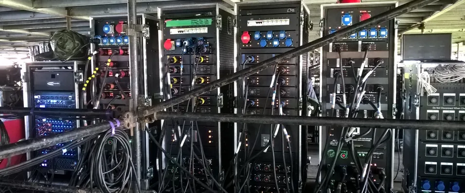

Event electrical systems have one big advantage over others, namely that much of the distribution has been pre-made so it all plugs together.
Concert in a field for 20,000 people? No problem, the electrical supplies, distribution and final circuits will be installed in a couple of days, tested and handed over. If it were made from scratch, it’d take many electrical wholesalers that long just to source all the hardware.
This is all good, but when the spectre of change to electrical standards loom, it can be a worrying time. When a temporary system is put together, it’s classed as a new installation, so should comply with the current version of BS 7671. In other words, from January 2019 every event will need to be compliant; having pre-built equipment that you can easily re-use is fine, until it needs changing. That is the Achilles heel of most systems; there is no physical room to add extra protection devices if it’s required, so changes can involve major – and expensive – re-engineering to stock equipment. It’s also possible that some distribution units could be rendered obsolete overnight. Ordinary electrical installations don’t have this issue so much; the distribution boards are specified based around the protection required given the requirements at the time.
