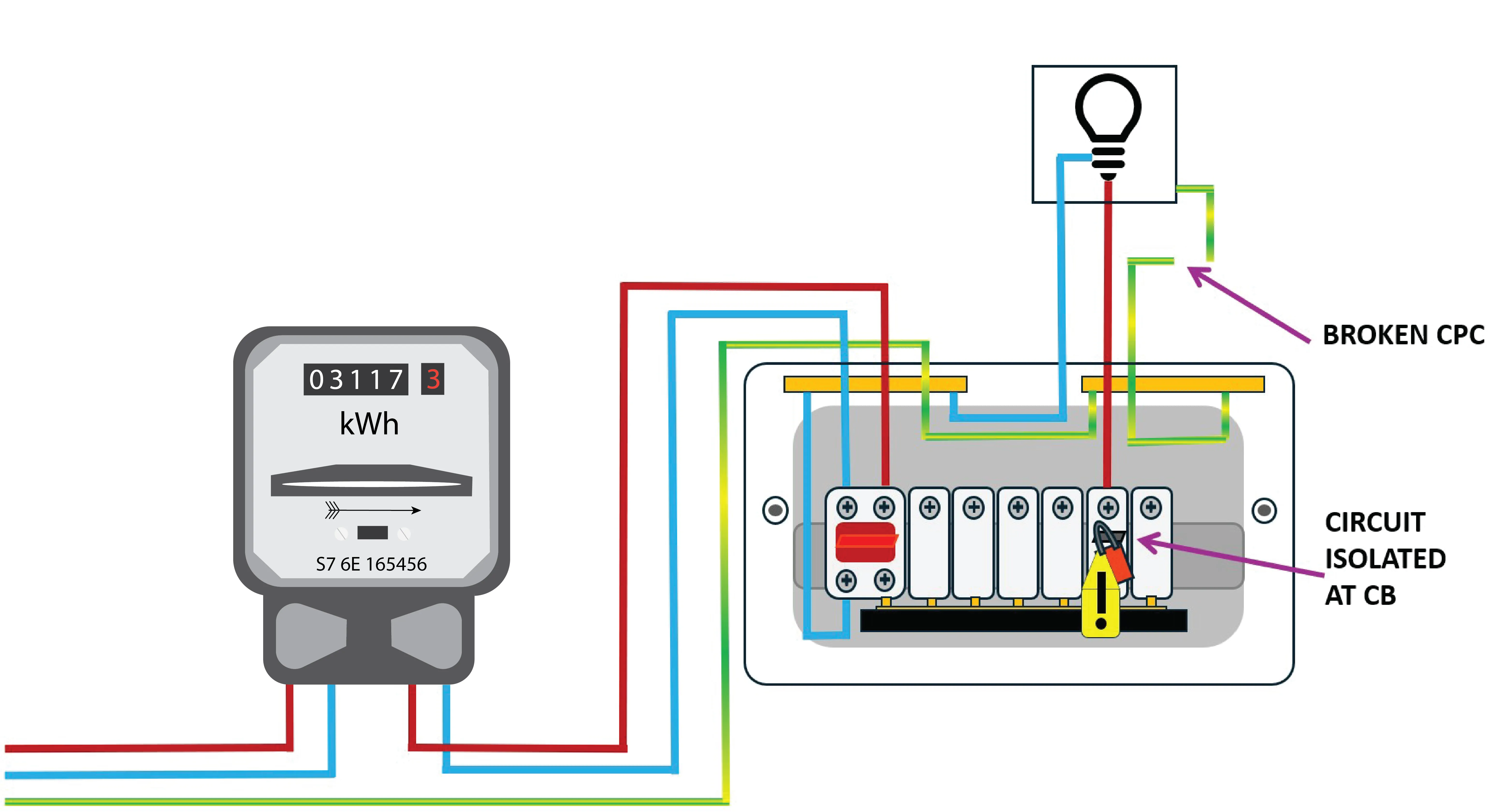

The answer was no. Unfortunately, Colin received a shock which was surprising to him as he was certain he did everything to the procedure.
So, what went wrong?

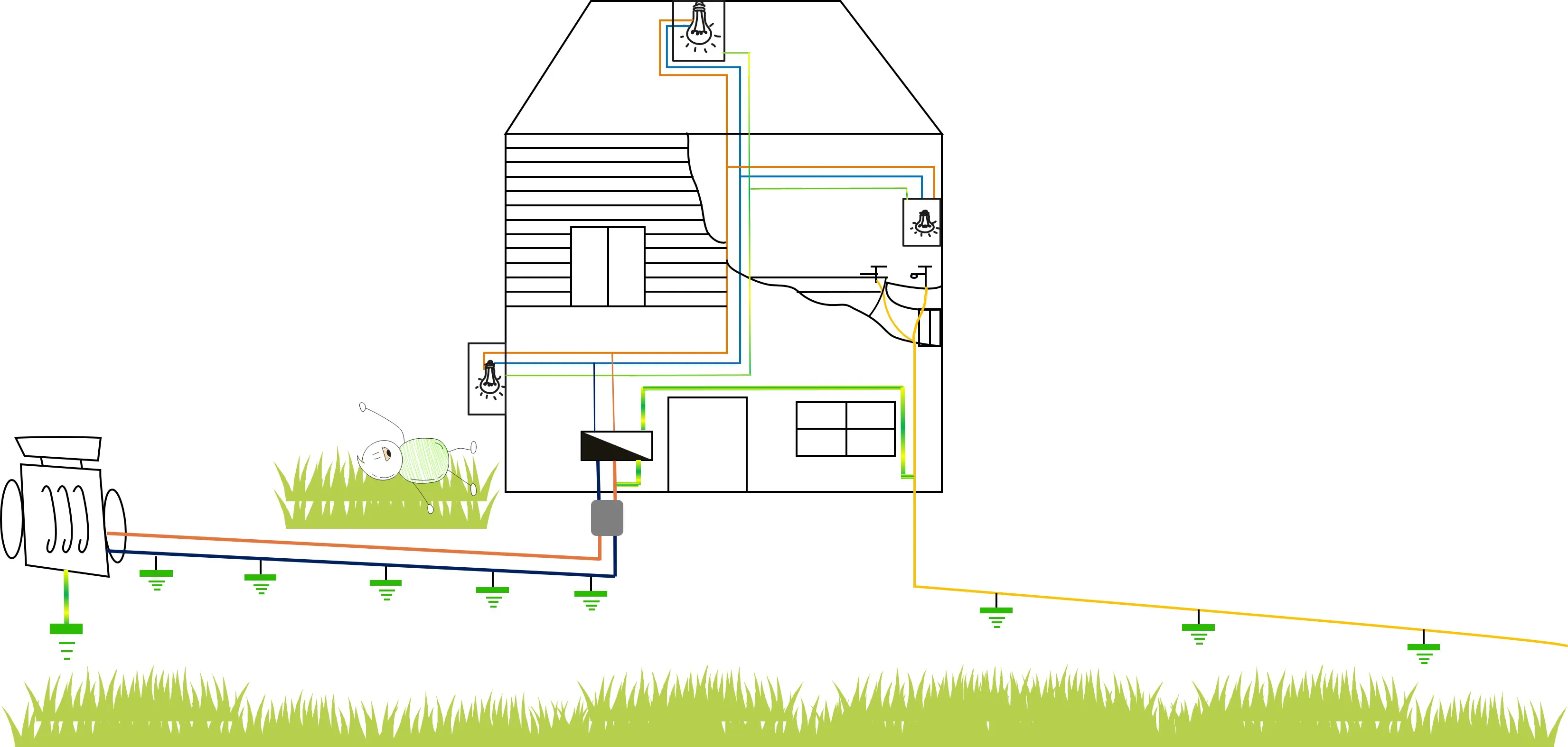

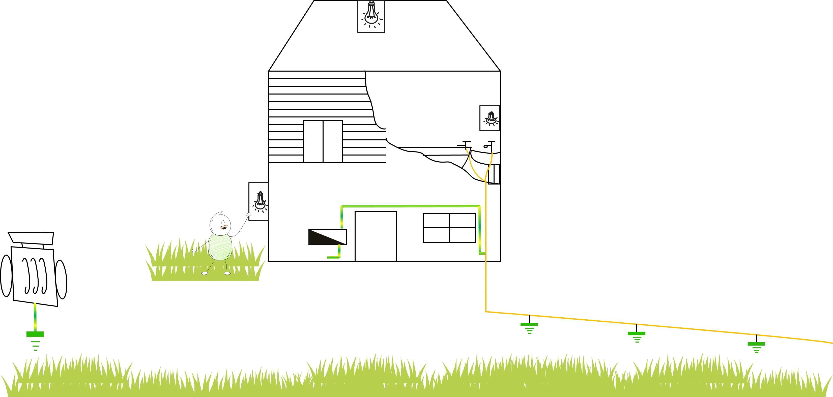

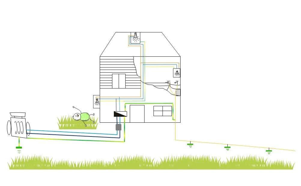

Unfortunately for Colin, the supply tails had been reversed by a recent replacement of the property’s energy meter and, compounding to that issue, the circuit protective conductor (cpc) at the light fitting did not have continuity back to the main earthing terminal (MET) as illustrated below.
This would mean that when he was at the light fitting, the neutral conductor was now his line conductor. There were no return paths for his voltage indicator to detect a potential difference. The CB was locked off in the open position and there was no continuity on the cpc. As a result of this, he was unable to detect the voltage present at the neutral terminal which gave him the shock of 230 V.

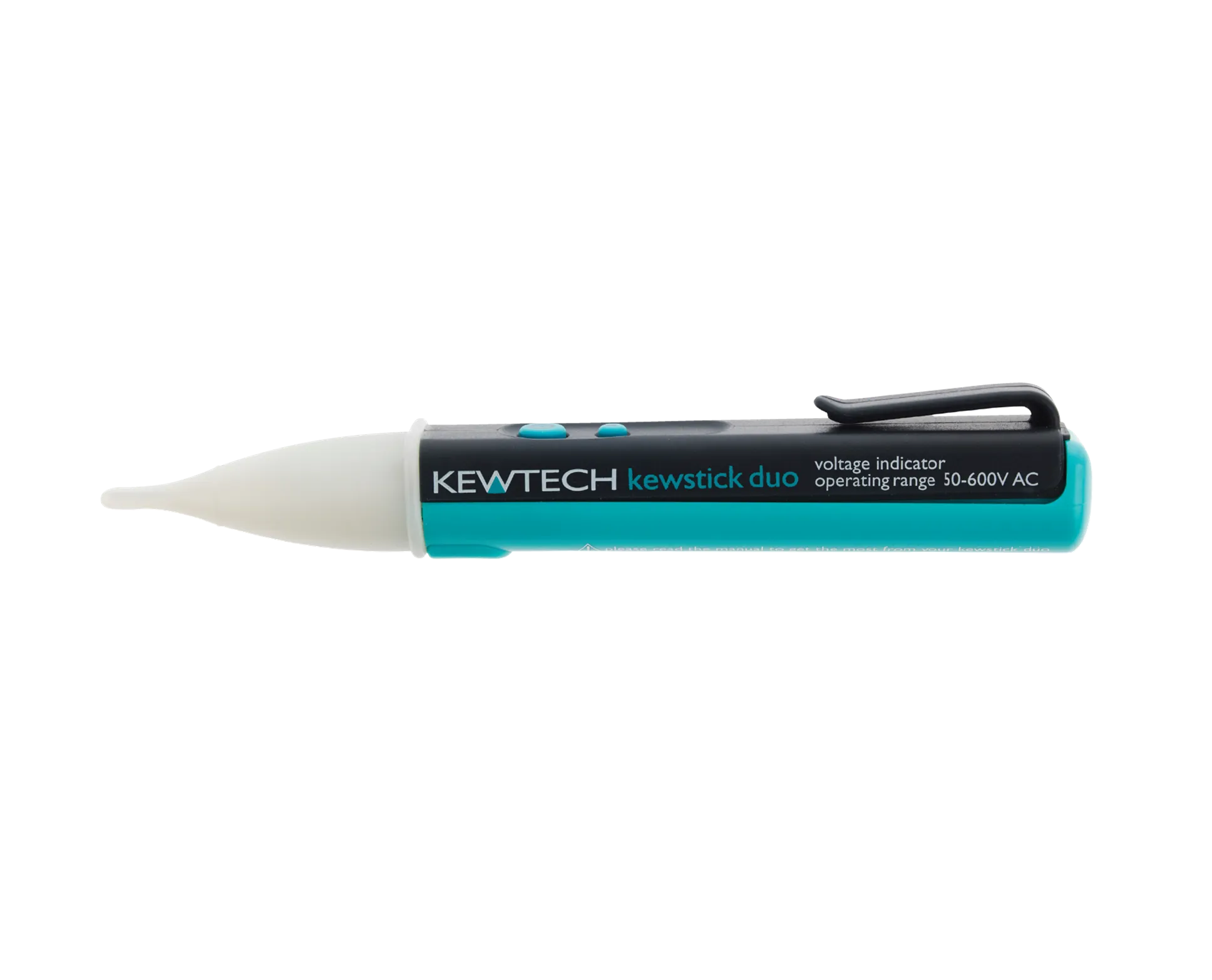

Non-contact and single pole contact voltage indicators

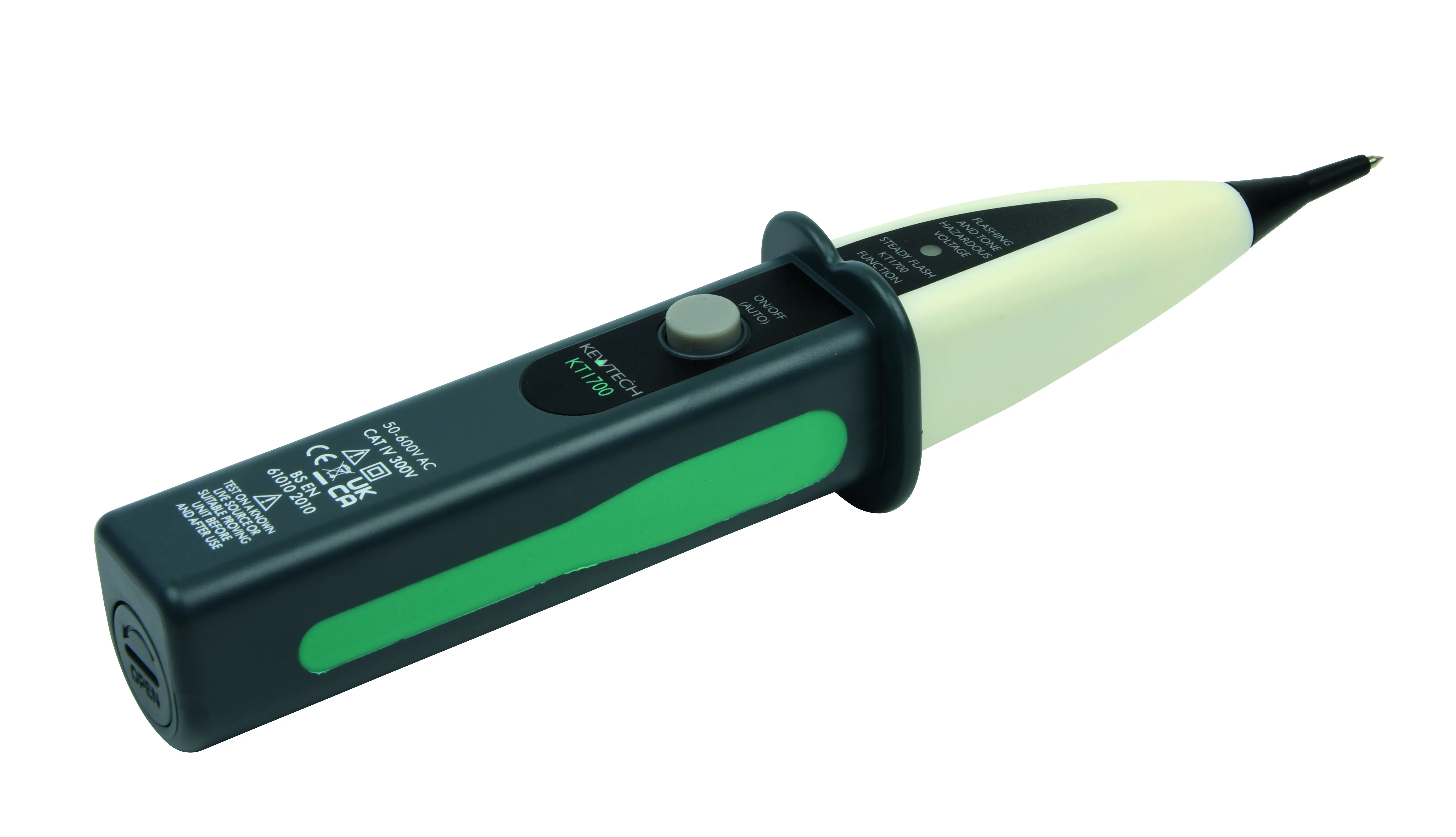

These are becoming increasingly popular for many to carry out their work safely. Many electricians, along with distribution network operators (DNOs) and heating engineers, often utilize these types of voltage indicator as part of their procedures. Better awareness of safe isolation and other hazards such as protective earthed neutral (PEN) failures (see Wiring Matters article, March 2021, “Broken PEN”) have meant new methods have been introduced. Unlike GS38, approved two-pole voltage indicators will require batteries to function. Like all measuring and testing equipment, they will need to be treated carefully, away from impacts, and will need to be checked before and after use on a known source.
Figure 1 Non-contact voltage indicator. Reproduced by permission of Kewtech.
Figure 2 Single-pole voltage indicator. Reproduced by permission of Kewtech.
Some two-pole voltage indicators warn of the presence of a voltage with the contact of one pole connected. The unit relies on batteries to function and will also need to be checked before and after each use on a known source or proving unit.

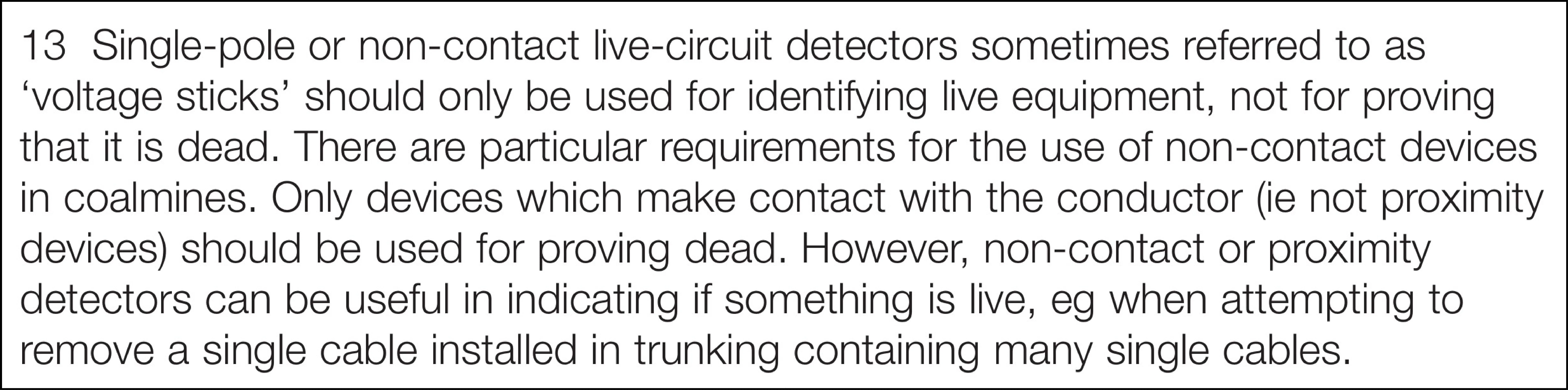

GS38 Electrical test equipment for us on low voltage electrical systems is a guidance note from the Health and Safety Executive explaining safe methods of using test equipment on low voltage electrical systems.
Section 13 of GS38 suggests how to use non-contact and single-pole devices safely:

Colin could have isolated the CU’s main switch. This would have isolated both poles and prevented the shock; however, he would still need an adequate procedure to identify and rectify the reverse polarity and cpc continuity issue before re-energizing.
