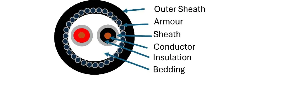

The development of new cables whereby a metallic sheath, or armouring, is applied to an insulated and sheathed cable (see Figure 1) requires careful consideration since the requirements for the protective method adopted for protection against shock in solar PV systems is given in Regulation 712.410.102 of BS 7671:2018+A2:2022+A3:2024, which states:
“On the DC side, one of the following protective measures shall be applied:
(i)    double or reinforced insulation (Section 412)
(ii)    extra-low voltage (SELV or PELV) (Section 414).”
The protective measure referred to in indent (i) is intended to prevent shock caused by the appearance of dangerous voltages on accessible parts of electrical equipment through the failure of basic insulation. There is also the additional concern of arcing where a second fault in insulation on the other pole occurs, which could cause a fire.
Figure 1 Non-standard SWA comprising insulated and sheathed cores contained within an armour constructed cable

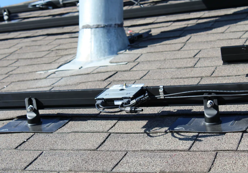

Can PV DC power optimizers or other devices provide ADS on the DC side?
It is to be noted that PV DC power optimizers are not recognized as a method of protection in BS 7671, however, they may provide benefits such as increased module performance and offer proprietary module shut-down options. These devices are module level electrical units that condition the output of a PV module or modules. Some are able to reduce the voltage and current in a string to a safe level when the inverter has detected certain faults.
Figure 2 PV DC optimizers fitted to solar rails prior to installation of PV modules
Nevertheless, the time taken for these devices to operate can be up to 30 seconds and their operation is dependent upon the inverter shutting down. The same is also true of firefighter safety switches; devices which can be used to switch off arrays or strings to reduce voltages in the event of a fire. The disconnection times are designed to protect against fire, not electric shock. Furthermore, the safety mechanisms built into the inverter also vary in the time taken to effect shut down and some only occur at wake up when the inverter starts to operate due to daylight being present. Thus, complying with the requirements for ADS associated with Regulation 411.3.2 of BS 7671:2018+A2:2022+A3:2024 for example, would be difficult to achieve.
