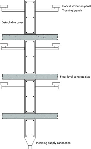

This article considers the basic requirements of passive fire protection, its certification and, more critically, the issue of whether a containment system (trunking) itself might pose a risk of thermal bridging and heat transmission between suitably sealed fire compartments against fire spread (see Figure 1).
Figure 1 Internal and external sealing at each floor level
This latter aspect considers whether the heat transmitted through the wiring containment system (trunking or similar) will be sufficient to cause spontaneous combustion in a compartment ostensibly sealed from fire.

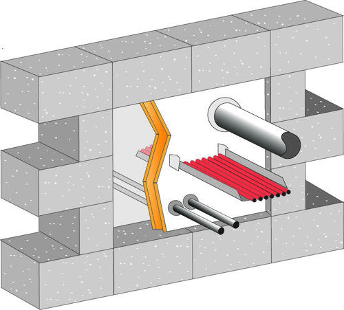

Section 527 of BS 7671 recognizes that wiring systems will need to make use of passive fire protection products. For example, Regulation 527.2.1 requires that where a wiring system passes through elements of a building construction (floors, walls, etc.), then the opening left behind shall be sealed “according to the degree of fire-resistance prescribed for the respective element of building construction before penetration” (see Figure 2). This requires, therefore, that where the construction element has, for example, a stated fire-resistance of 120 minutes, then any opening should be sealed to the same value.
Figure 2 Sealing of external penetration
Furthermore, Regulation 527.2.2 requires that wiring systems penetrating elements of building construction having specified fire-resistance shall be internally sealed to the same degree of fire resistance of the respective element. However, where the internal cross-sectional area does not exceed 710 mm2, the conduit system, cable ducting system and trunking system are classified as non-flame propagating, according to the relevant product standard (Regulation 527.2.3).
It is not important merely to seal; it is also important that the sealing arrangements are suitable for the wiring system and the cables which are part of the system (Regulation 527.2.4). Specifically, Regulation 527.2.4 requires that the sealing products:

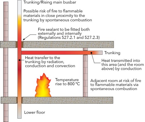

Where a fire exists within a fire compartment for, say, 30 minutes, the rise in the temperature of the metallic containment system will rise to a value not dissimilar to the temperature of the fire itself (see Figure 3).
Where this is the case, the distance between the top of the containment system in the lower compartment and the temperature of the containment system in the compartment above will be little different. Indeed, it is likely that for a significant length, the temperature of the containment system will still be at a value sufficient to create the conditions for spontaneous combustion in neighbouring materials in proximity to the containment system.
Figure 3 Heat transmission through trunking. Courtesy of T.J. Bratley.

Where containment systems span between fire compartments, the designer and installer should not only carefully consider the passive fire protection issues, but they should also take care to limit thermal bridging, and the risk of fire spread by means of heat transmission through the metal of the containment itself.
Metallic containment systems enclosed in fire-resisting material, such as suitable plasterboard, will take significantly longer to rise to a temperature where heat transmission creates conditions for spontaneous combustion in those areas not affected by fire.
Where it is not possible to install containment systems in locations separate from fire compartments, metallic containment systems should be installed behind fire-resisting material to limit the risk of heat transmission.
