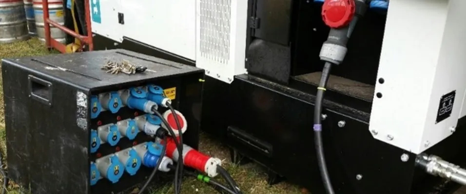

The concern is that distribution boards which are fitted with connectors (exampled in Figure 1) are not as suitable for use in a typical construction environment, unlike typical steel framed boards to which incoming and outgoing circuits are manually terminated (as illustrated in Figure 2).
Figure 1 Distribution board fitted with plug and socket connectors

Note that Regulation 704.511.1 refers to BS EN 60309-2 connectors (‘Commando’ or ‘Ceeform’ types) which is of course a characteristic of the distribution boards shown in Figure 1. Regulation group 704.522.8 goes on to state requirements for cable, noting that H07-RNF types should be used for low voltage supplies which are commonly used with BS EN 60309 connectors in this application. The common single-pole connectors used for supplies over 125 A (often referred to by the brand name ‘powerlock’) are also catered for in Regulation 704.511.1.
With these requirements in mind, it can be seen that BS 7671 does not preclude the use of such distribution boards if they comply with BS EN 61439-4 and where connections are made by plug and socket, that the connections use BS EN 60309-2 connectors as depicted in Figure 1.
In respect of compliance with standards, distribution boards should be manufactured to BS EN 61439-1 and additional specific requirements for assemblies for construction sites (ACS) are given in BS EN 61439-4. This has requirements for service conditions such as ambient air temperatures, humidity and pollution levels. Part 4 also has specific requirements for labelling, handles, accessible parts and terminals for external conductors. Notably, this has requirements for terminals for external conductors, stating “All connections shall be rewireable or shall be socket-outlets.”
Assuming the distribution unit is constructed to comply with Part 1 of BS EN 61439, suitably IP rated and complies with the additional mechanical, impact and corrosion requirements of Part 4, there are no particular requirements that would preclude the use of the distribution boards exampled in Figure 1.

The distribution boards examples in Figure 1 fulfill both these requirements admirably. They have long been in used in events and entertainment where such portability and robustness are key factors as they are often used in different locations on a daily basis and in quite arduous conditions.
Assuming a distribution board complies with BS EN 61439, there is no reason why it cannot be used on construction sites whether fitted with connectors or other terminations. Even if the mechanical or IP rating requirements cannot be complied with, BS 7671 does allow for additional measures to be put in place to achieve an equivalent level of protection.
