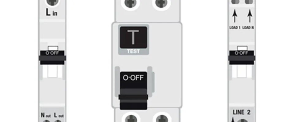

Unidirectional protective devices are marked to indicate the line and load terminals and are designed to work when the power can only flow in one direction, i.e., from supply to load. It is vital to observe the connection details.
Single-module sized residual current breakers with over-current protection (RCBOs) have been available for several decades and utilize electronic circuits to provide residual current protection. These compact RCBOs contain electronic components and are typically unidirectional. Arc fault detection devices (AFDDs) are also typically unidirectional.
The product standard for RCBOs states that if it is necessary to distinguish between the supply and load terminals, they shall be clearly marked, for example, by line and load placed near the corresponding terminals or by arrows indicating the direction of power flow. Therefore, if a device is marked line, load, with arrows etc, it is indicating that it is necessary to distinguish between the supply and the load terminals. Not all compact RCBOs are unidirectional. Some RCBOs employ technology/solutions that ensure that the RCBO is not damaged when supplied in either direction and these are bidirectional.
What is a bidirectional protective device?
A protective device that does not have markings to indicate line and load terminals is a bidirectional device, where power flow in either direction will not cause damage.
The 'typical' residual current circuit-breaker (RCCB) is an electromechanical device, however, electronic RCCBs also exist. RCCBs for consumer units are in the form of a two module-sized device. These devices are not usually marked in and out, and therefore are bidirectional. In some cases, RCCBs are marked to indicate the terminals to which the neutral or line should be connected.
Single-phase RCBOs are available in a single module, known as ‘compact’, and two module sizes. Two module RCBOs are not usually marked as with circuit-breakers (CBs), and thus are also bidirectional.
How are unidirectional protective devices marked?
Where required, protective devices such as CBs, RCCBs, RCBOs and AFDDs feature a marking on the device to distinguish between the supply and load terminals. This can be marked in a number of ways such as, line and load, in and out, or by using directional arrows to indicate the power flow. The connection details are shown in Figure 1.
Figure 1 Protective device connection details
