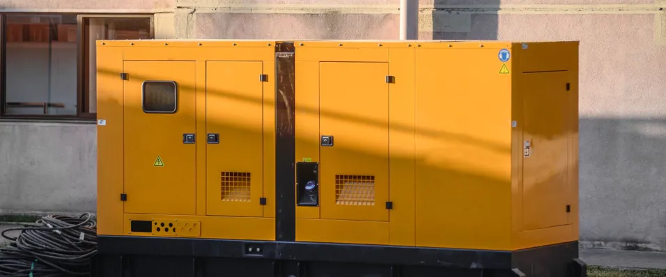

Section 551 Low voltage generating sets
Section 551 covers generators with several supply arrangements. Regulation group 551.7 sets out additional requirements for installations where the generating set may operate in parallel with other sources, including systems for distribution of electricity to the public. In this situation, it is very important that where energy flow is bidirectional, the correct type of protective device is installed.
Good workmanship and proper materials should always be used. To comply with this requirement, the installation of electrical equipment must take account of the manufacturer’s instructions as stated in both Regulation 134.1.1 and Regulation 510.3.
To clarify the requirements in this situation, Regulation 551.7.1 has been redrafted. An indent (c) has been added, which requires a suitable protective device where energy flow is bidirectional.
In addition, an indent (d) has been added which prohibits the connection of a source to the load side of an RCD under certain conditions.
Regulation 551.7.2 has been redrafted to form two regulations. Regulation 551.7.2.1 requires the generating set to be installed on the supply side of all the protective devices and requires stationary batteries (Chapter 57) to be considered a generating set and not a load.
Regulation 551.7.2.2 sets out the requirements for the low voltage switchgear and controlgear assembly when a generating set is used as an additional source of supply in parallel with another source and the generating set is connected via low voltage switchgear.
Regulation group 551.8 deals with the requirements for installations incorporating stationary batteries. The requirements for stationary batteries have been transferred to a new Chapter 57 and therefore this group of regulations have been deleted as part of Amendment 4.
