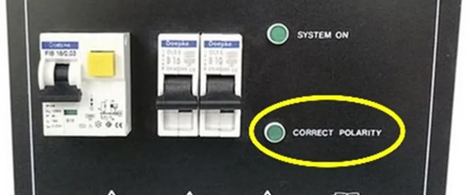

While ISO 13297 provides no guidance on the location of any reverse polarity indicator, it should be noted that some suppliers of ready‑made 230 V AC panel boards, have, (for reasons best known to themselves), decided to fit a ‘polarity correct’ indicator – see circled area of Figure 2. If you’ve already ‘joined the dots’, you’ll have realized that such indicators need to be connected between the incoming supply line and PE conductors to function in the manner described on the caption and are therefore non‑compliant to the requirements of both ISO 13297 and IEC 60092-507.
Figure 2 230 V AC panel board with a polarity indicator

Now that we’ve introduced means to minimize the effects of galvanic corrosion attributable to the shore-power connection, we need to address the problem that arises when non‑compliant polarity correct indicators are fitted - which is leakage current.
As previously mentioned, polarity correct indicators are connected between the line and PE conductors thereby providing a leakage path to Earth via the hull and the surrounding water. While this current will be small, its presence will accelerate erosion of any cathodic protection (anodes) fitted to the boat. To eliminate this problem, an appropriately rated momentary press switch can be fitted in line with the indicator.
