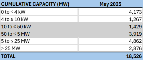

Solar PV deployment
Table 1 presents the cumulative capacity of solar PV installations in the UK as of May 2025, broken down by system size. Historically, systems up to 4 kWp were classified as part of the domestic market (row 1), although these systems have been increasing in capacity. Commercial and industrial embedded systems typically range from 10 kWp up to several MWp (rows 3 and 4). By this classification, commercial and industrial solar PV accounts for approximately 29% of the UK’s total installed solar PV capacity.
Table 1 Total solar PV deployment in the UK, reproduced from Department for Energy Security and Net Zero, May 2025 National Statistics

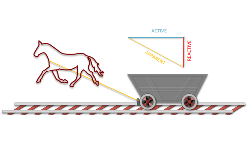

Figure 1 provides an analogy to help explain power factor. While the horse moves forward to pull the carriage, there is also a force acting at a right angle to the direction of travel. This sideways force requires the horse to exert more power than if it were pulling straight ahead. In this analogy, the forward movement represents active power, the force acting at a right angle represents reactive power and together they combine orthogonally to form apparent power.
Figure 1 Horse and carriage power factor analogy
Apparent power is the product of the voltage multiplied by the current with no consideration for the phase angle between the two.
Active power is the power that carries out work and accounts for the phase angle between the voltage and current.
Reactive power is power that is transferred back and forth from the supply and load and does no direct work.

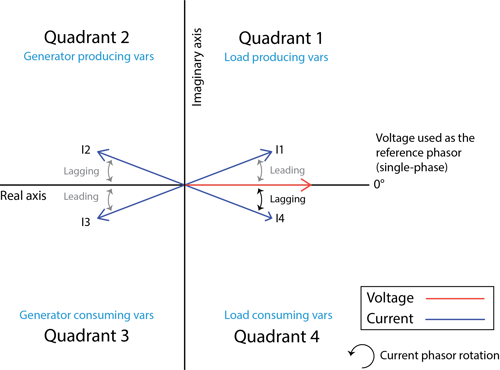

Figure 2 represents a phasor diagram with multiple current phasors (I1- I4), using the voltage as the reference phasor (at 0o). The current phasors are described as follows:
  • I1: Current of a capacitive load with a 0.96 leading power factor
  • I2: Current of a generator with a 0.96 lagging power factor
  • I3: Current of a generator with a 0.96 leading power factor
  • I4: Current of an inductive load with a 0.96 lagging power factor.
Figure 2 Phasor diagram
A generator operating at a 0.96 lagging power factor (quadrant 2, I2) can supply the reactive power (vars) required by a load with a 0.96 lagging power factor (quadrant 4, I4), providing the currents are of equal magnitude.

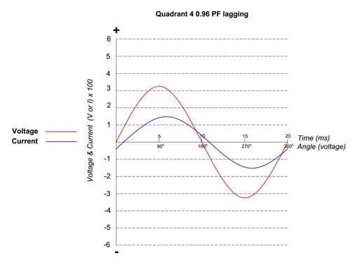

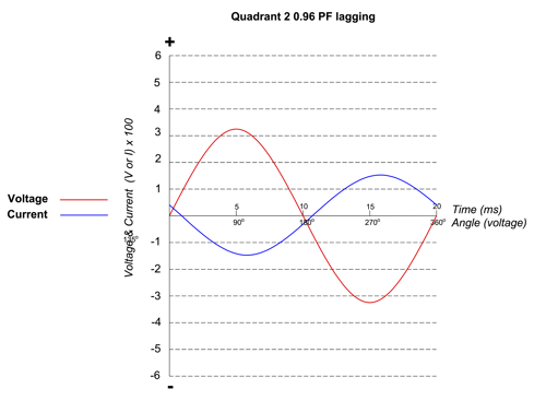

Each of the currents (I1- I4) are also represented in Figure 3 as waveform diagrams to illustrate the leading and lagging behaviour of the currents.
Figure 3 Waveform diagram representing the four quadrants

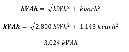

As per Equation 5, the active energy delivered to site from the energy supplier would be 2,800 kWh, while the reactive energy required would remain at 1,143 kvarh. The new power factor, as observed from the energy supplier, can be calculated as follows:
Equation 6
Equation 7
PF = 0.93 (to two significant figures)
With the new values, the PV system has negatively impacted the installation’s power factor as seen from the supplier, reducing it from 0.96 to 0.93. This, in turn, lowers its efficiency from the perspective of the energy supplier.

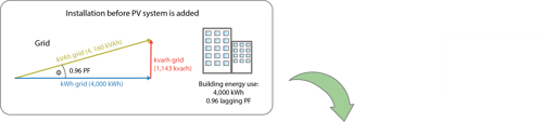

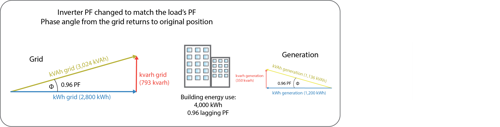

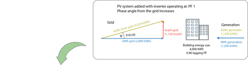

Figure 4 illustrates the power factor triangles of the installation shown from the energy supplier’s perspective, across three distinct stages:
  1. Before the PV system is added
  2. With the PV system added operating at a PF of 1
  3. With the PV system added operating at a PF matching the load.
Figure 4 Power factor impact visualized
Figure 4 demonstrates that upon integrating the PV system without reactive power support, the phase angle (Φ) increases from its original value. However, once the inverter's power factor is adjusted to match the load, the phase angle returns to its initial position.

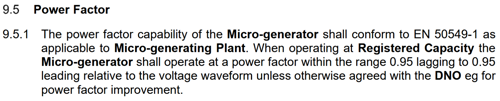

When connecting a PV system to the grid for parallel operation, compliance with Engineering Recommendation G98 (for systems ≤16 A per phase) and Engineering Recommendation G99 (for systems >16 A per phase) is generally required. These recommendations mandate that the inverter has a specified power factor operating range and may also require the PV inverter to provide reactive power control. Relevant excerpts from these documents include:
Figure 5 9.5.1 of EREC G98 Issue 1 Amd 7: Oct 2022
Figure 6 11.1.5 of EREC G99 Issue 1 AMD 9: OCT 2022
Figure 7 11.1.6 of EREC G99 Issue 1 AMD 9: OCT 2022
