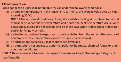

  • Clause 4 of BS 1363-4:2023 (see Figure 1) states the conditions in which the connection unit to the standard should be used; in ambient temperatures of −5 °C to +40 °C, where the average value over 24 hours is not exceeding 25 °C, and in situations not subject to exposure to direct radiation from the sun or other sources of heat likely to raise temperatures above these limits. BS 1363-1:2023 and BS 1363-2:2023 contain the same provision.
  • Regulation 134.1.5 of BS 7671 states that “electrical equipment shall be installed in such a manner that the design temperatures are not exceeded.”

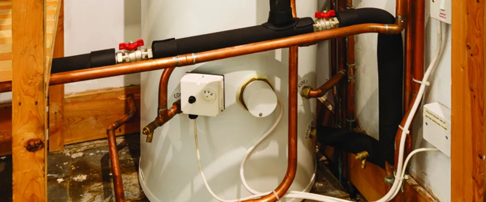

It is therefore clear that FCUs or SFCUs meeting only the basic requirements of BS 1363-4, and plugs and socket-outlets to BS 1363-1 and BS 1363-2, are unlikely to be designed to operate at its rated current if located in an airing cupboard or small room containing a hot water cylinder, because of the increased ambient temperature for long periods.
Figure 1 Clause 4 of BS 1363-4:2023

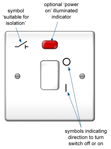

Immersion heaters should be supplied via an appropriately-rated double-pole switch (for example, 20 A for a 3 kW immersion heater) within easy reach of the heater, and a flexible cable outlet (integral with or separate to the switch). The immersion heater switch is generally used for the function of isolation when replacing the heater element or thermostat, therefore, the switch should conform to BS EN 60669-2-4 and be marked with the symbol illustrated in Figure 2.
Immersion heaters fitted to storage vessels in excess of 15 litres capacity should be installed on their own final circuit. Regulation 554.2.1 of BS 7671 also states: “Every heater for liquid or other substance shall incorporate or be provided with an automatic device to prevent dangerous rise in temperature.”
Figure 2 Example of marking on switches to BS EN 60669-2-4
