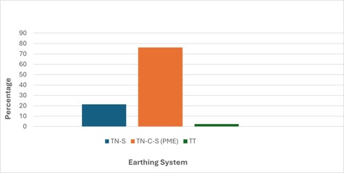

What was the most common earthing system reported?
The TN-C-S protective multiple earthing system (PME) was the most common form of system recorded approximately 76 % of the time, followed by the TN-S system at 22 %, and the remaining 2 % being TT systems (see Figure 1).
Figure 1 Most common earthing systems reported
It is widely accepted that the TN-C-S (PME) system is provided for new installations. A cable which contains phase conductor(s) and a combined protective earth and neutral conductor is used within the distributor’s network. This combined conductor is used for the protective earthing and neutral functions and is known as the protective earthed neutral (PEN) conductor.
Whilst BS 7671, Requirements for Electrical Installations1, “Part 2 Definitions”, refers to the term ‘PEN conductor’, it is common for Distribution Network Operators (DNOs) to use the term combined neutral and earth (CNE) cable. Neutral current diversion (NCD) occurs where the PEN conductor is broken.
Prior to the introduction of PME, the network cable of choice was the separate neutral earth (SNE) cable. However, SNE cables in the network have become increasingly rare due to modifications, fault repair and the increase of CNE cables installed within sections of the network. The Energy Networks Association (ENA) provides guidance on PME networks in the form of the Engineering Recommendation G12, Requirements for the Application of Protective Multiple Earthing to Low Voltage Networks, Issue 5, 20232 and references the term ‘hybrid network’ where SNE (TN-S) cables were originally installed and, over time, CNE cables have been inserted. The TN-S system requires a continuous earth connection all the way back to the supply transformer; however, with the rise in the number of hybrid networks, it could be argued that very few TN-S systems exist in the public distribution network.
Recognizing this, the IET Code of Practice for Electric Vehicle Charging Equipment Installations, 5th Edition3, has advised designers to treat TN-S systems as TN-C-S (PME) unless it can be guaranteed that the TN-S system extends back to the supply transformer and will not be modified in the future. An example of this could be where a TN-S system is supplied by a private transformer.
Where older installations may have been converted from a TN-S to TN-C-S (PME) system, the cross-sectional area of any main protective bonding conductors should be verified as suitable for continued use. This is due to older installations often having smaller main protective bonding conductors in situ; this, coupled with the risk of open PEN conditions in TN-C-S (PME) systems, may increase the risk of thermal damage to conductors.
While the amount of TT systems recorded was low, it is important to consider that in the event of an open PEN conductor, voltage could appear on a TT system. Designers are therefore required to maintain separation below ground between earth electrodes and buried conductive parts connected to TN-C-S (PME) systems. Local DNOs may have specific requirements for maintaining separation, which should be confirmed before installation. For additional guidance, see BS 7340:2011+A1:2015 Code of practice for protective earthing of electrical installations4, which contains information on potentials around earth electrodes.

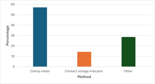

What method was used to determine neutral current diversion?
The application of a clamp meter, both before and after isolation of the installation, provides a useful check of any current flowing in the earthing conductor and the main protective bonding conductor(s) while identifying changes in load. Approximately 57 % of those who responded utilized a clamp meter to determine NCD, a method identified in Table D1 of the IET’s Guidance Note 3: Inspection & Testing, 9th Edition5, followed by 14 % who used a contact voltage indicator. Other methods included the use of multimeters, data loggers and visual signs of arcing, making up the remaining 29 % (see Figure 2).
Figure 2 Method used to determine neutral current diversion
One respondent reported they were first alerted to the possibility of current diversion due to sparks on the gas service installation pipework when verifying the continuity of conductors (test method 2) with the installation isolated.
Within older electrical installations, extraneous-conductive-parts often take the form of metallic water and gas installation pipework, as opposed to the modern-day preference of plastic. In the case of an open PEN conductor, the path the current takes is effectively determined by the load and impedance on the network. Extraneous-conductive-parts offer low impedance paths for neutral current to flow, potentially resulting in a significant heat build-up that can lead to fires and gas explosions.
Another respondent reported that the current recorded at the installation they were working at was subsequently found to have originated from an adjoining installation. This is a general theme of the comments and highlights that NCD can affect multiple installations at a time.

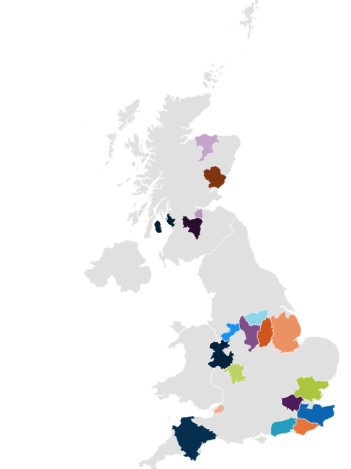

Where was neutral current diversion reported?
The results have highlighted parts of the UK with significantly higher occurrences of NCD, for example, the Midlands and the South East of England; however, no significant volumes of NCD were reported in Wales, Northern Ireland and the North of England (see Figure 4). The rationale behind obtaining the location of NCD is to identify patterns of occurrence, be that in a specific part of the UK, DNO or several incidents within the same postcode region.
Figure 4 Map of the UK indicating where neutral current diversion was reported
While we have received a great deal of information regarding NCD incidents from industry, we feel that additional information would only benefit our research; therefore, we have decided to leave the survey open at this point to continue our investigation.
