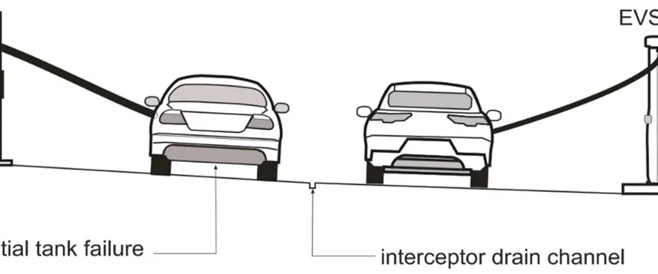

From the “Blue Book”, we have a new requirement and example figure that designers and installers must consider regarding any likely extent of liquid fuel spills, dependent upon paving, drainage and degree of containment.
For example, if there is a gradient sloping towards an EV charging area from the fuel filling area, such that fuel from a spill may run into the charging area, consideration should be given to the installation of a suitable drainage channel to divert any spilt fuel to the site oil/water separator.
Figure 1 Consideration of site gradients and possible need for a drainage channel, copyright © APEA.
