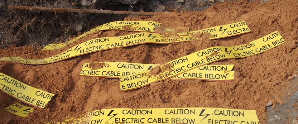

What is suitable marking for buried cables?
Regulation 522.8.10 of BS 7671:2018+A2:2022 requires the location of buried cables to be marked by cable covers or a suitable marker tape. Cable covers or marker tape is laid above the buried duct or cables to provide an early warning that electric cables are present (see Figure 1 and Figure 2). Some marker tapes include a metallic strip which can be detected using a cable detection tool.
To offer additional mechanical protection, cable covers can be installed above ducts to provide an early indication there are electric ducts present (see Figure 2).
Figure 1: Cable marker tape
