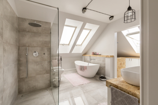

Room containing a bath or shower
Socket-outlets
Are 230 V socket outlets permitted in a room containing a bath or shower?
230 V 13 A socket-outlets are allowed but only if they are at least 3 m horizontally from the boundary of zone 1.
Plate switches
Are 230 V lighting switches (plate switches) permitted in a room containing a bath or shower?
A plate switch is allowed outside the zones of a bathroom. A switch must be suitable for the location. The cords of cord-operated switches are allowed in zones 1 and 2 and are recommended for bathrooms and shower rooms.
Luminaires (light fittings)
Are 230 V light fittings permitted above a shower or bath (zone 1) in a room containing a bath or shower?
Yes, 230 V fittings may be installed above a shower or bath, but they must be at least IPX4.
Extractor fans
Are 230 V extractor fans permitted in zones 1 and 2 of a room containing a bath or shower?
Yes, a suitable 230 V extractor fan may be installed in zones 1 and 2, and outside the zones. If an extractor fan is installed in zone 1 or 2 it must be protected against the ingress of moisture to at least IPX4.
An extractor fan supplied from a lighting circuit for a bathroom without a window should have its own means of isolation, as otherwise replacement or maintenance of the fan would have to be carried out in the dark. An isolation switch for a fan with an overrun facility will need to be triple-pole (switch wire, line and neutral), and must be installed outside zones 0, 1 and 2.
Supplementary bonding
Does supplementary bonding need to be installed?
Regulation 701.415.2 (last paragraph) allows supplementary bonding to be omitted where the location containing a bath or shower is in a building with a protective equipotential bonding system in accordance with Regulation 411.3.1.2 and provided all of the following conditions are met:
  • All final circuits of the location comply with the requirements for automatic disconnection according to Regulation 411.3.2.
  • All final circuits of the location have additional protection by means of an RCD in accordance with Regulation 701.411.3.3.
  • All extraneous-conductive-parts of the location are effectively connected to the protective equipotential bonding according to Regulation 411.3.1.2.
