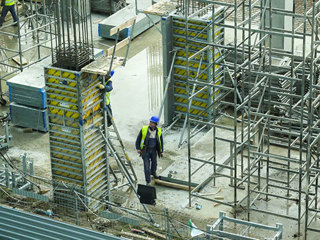

Construction sites are potentially dangerous in many ways. The risk of electric shock is high on a construction site because of:
  1. the possibility of damage to cables and equipment
  2. the wide use of hand tools with trailing leads (this problem is mitigated by the increasing use of battery-operated tools)
  3. the accessibility of many extraneous-conductive-parts, which cannot practically be bonded, and
  4. the works are generally open to the elements.
Section 704 prescribes particular measures to reduce the risks caused by this harsh environment. The DPC on the 18th edition (BS 7671:2018) contains a number of small changes, including requirements for external influences, and modifications to Regulation 704.410.3.6 concerning the protective measures of obstacles, placing out of reach and electrical separation.
