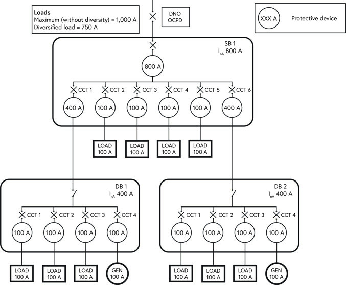

Figure 1 shows an example where the total connected load is 1,000 A (10 x 100 A) and the total diversified load is 750 A. The design does not meet the requirements of Regulation 551.7.2 of BS 7671:2018+A2:2022+A3:2024 because the rated current of the upstream OCPD for SB 1 is 800 A and the total rated output of the generating sets connected to SB 1 is 200 A, giving a total of 1,000 A. This exceeds the rated current of the assembly of 800 A as shown in Equation 1 below:
Equation 1
Equation 1
However, the total possible load current (ITPL) connected to SB 1 cannot exceed the rated current of the assembly (InA) in normal service. Therefore, the design is no less safe than compliance with BS 7671:2018+A2:2022+A3:2024. The possible scenarios are as follows:
Scenario 1 – No generation
With no generation, the incoming protective device ensures the assembly cannot be overloaded.
Scenario 2 - Generation at maximum
Circuit 1 and circuit 6 cannot be a load and generator at the same time. If there is no power demand at either DB 1 or DB 2, the total generation at SB 1 is 200 A and the total possible load of circuit 2 to circuit 5 is 400 A. Therefore, the total current at SB 1 in this scenario cannot exceed 600 A due to the total possible load current.
scenario 2 gen at max
Scenario 3 - Only one generator is operating
If the generator at DB 2 is not in operation, the maximum generation at SB 1 is 100 A (from DB 1). The total outgoing protective ways is 700 A (circuit 2-5 of SB1 and circuit 1-3 of DB2). The total current at SB 1 in this scenario is 800 A.
Scenario 3
Scenario 4 – Minimal loads
In a scenario where there are minimal loads, such as when the business is closed (this could be on a Sunday), the maximum current that can be exported through SB 1 is 200 A.
It can be seen that, based on all possible load flow analyses, there is no risk of overloading the assembly. The designer may choose to install suitable notices or schematics indicating how the assembly is protected from overload. This will assist future designers in complying with Regulation 132.16 “Additions and alterations to an installation” of BS 7671.
Figure 1: Example of an intended departure from Regulation 551.7.2
Method of intended departure applied: SB 1
Requirement: SB1 InA ≥ total possible load current distribution (highest power dissipation) (ITPL).
This includes the current supplied through the generator circuits 1 and 6 with no load demand at either DB 1 or DB 2. Whilst a generator might not be considered an electrical installation load, it is an incoming circuit creating heat and temperature rise within SB 1.
•    Circuit 2 through to circuit 5 total connected load = 400 A
•    DB 1 Ig 100 A + DB 2 Ig 100 A = 200 A
•    ITPL = 400 A + 200 A = 600 A
•    InA ≥ 600 A
•    SB1 InA = 800 A.
InA 800 A provides a resulting degree of safety not less than Regulation 551.7.2 because InA ≥ ITPL.

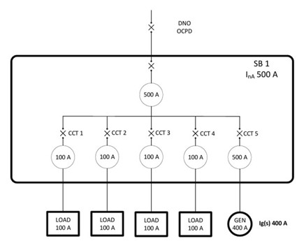

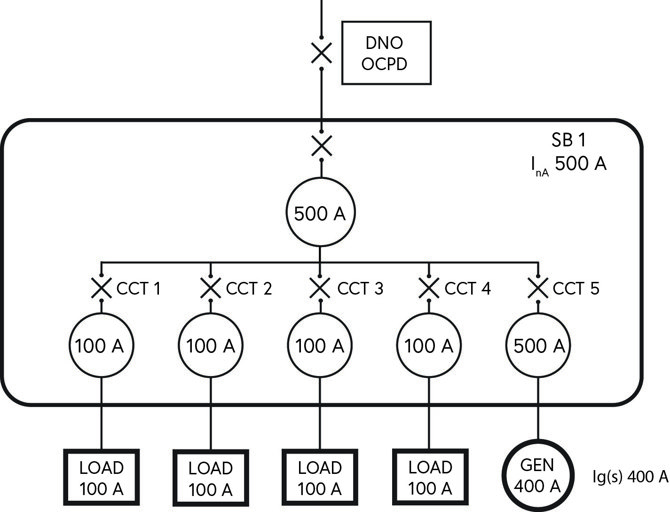

Figure 2 provides another example. In this scenario, the assembly has a rating (InA) of 500 A, the incoming protective device is rated at 500 A and the parallel generation has a rated output of 400 A. Equation 2 shows that this configuration does not meet the requirements of Regulation 551.7.2 indent (v) of BS 7671:2018+A2:2022+A3:2024. To comply with this regulation, the assembly would require a minimum rating of 900 A. The next common ‘off the shelf’ assembly may be rated at 1,600 A, which comes with additional costs and materials that may not align with sustainability principles.
Figure 2: Example assembly configuration
Equation 2
Looking at Figure 2, the characteristics of the load, i.e. total connected load without diversity, means the assembly could be suitable. This is subject to the assembly manufacturer’s verification of the InA to BS EN IEC 61439, with the generator incoming supply connected at this point for the specific arrangements. Particular attention should be given to any assembly manufacturer’s derating factors for adjacent, simultaneously loaded, grouped circuits.
What needs to be considered is the heat inside the assembly. The InA rating is not exclusive to the rating of the busbars. Manufacturers of assemblies carry out temperature rise verification based on the loading of the assembly. The I2R losses from the protective devices produce heat inside the enclosure. The designer must ensure no additional heat outside of the parameters of the assembly design is provided by the generation. In the scenario from Figure 2, the heat emitted from the protective device for circuit 5 would have otherwise been emitted by the incoming device if of the same type (e.g. thermal-magnetic) and rating. The designer shall also ensure there is no possibility of overload when the system is exporting to the network.
