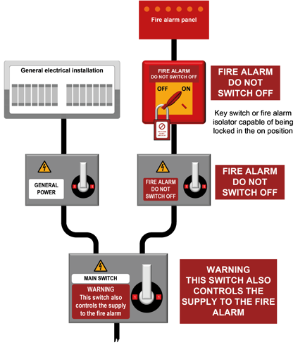

Are double-pole isolators required for fire detection and fire alarm systems?
When carrying out any work on a fire detection and fire alarm system, safe isolation is essential. BS 5839-1:20174 removed the need for a double-pole isolator to be provided as a means of isolation for the system. However, the requirement for safe isolation remains, and this is reinforced by Regulations 12, 13, 14 and 16 of the Electricity at Work Regulations (EAWR) 19895 or EAWR (Northern Ireland) 19916.
Although the need for double-pole isolation was removed from BS 5839-1:2017, Regulation 462.2 of BS 7671 requires every circuit to be provided with isolation for all live conductors, except for TN-C-S and TN-S systems where the neutral or protective earthed neutral (PEN) conductor is reliably connected to Earth. Therefore, where TT systems are present, double-pole isolation is required (see Figure 1).
Figure 1: Example of a fire detection and fire alarm system with a double-pole isolator, taken from the IET Electrician's Guide to Fire Detection and Fire Alarm Systems, 3rd Edition7
fire detection alarm circuits
