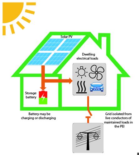

  • remote or automatic control of supply transfer arrangements when switching to island mode (where the installation ceases to be connected to the grid, and is supplied from local generation sources such as energy storage systems and solar PV (see Figure 1)).
Figure 1 Domestic loads powered in island mode
