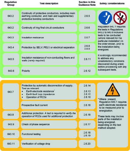

What tests are required to be carried out by BS 7671?
Regulation 643.1 of BS 7671 states that the tests of Regulation 643.2 to 643.11, where relevant, shall be carried out and the results compared with relevant criteria. The words “where relevant” are important as they mean exactly that.
The sequence of tests for initial verification in Figure 1 is extracted from IET Guidance Note 3: Inspection & Testing, 9th Edition. The tests are described in Regulations 643.2 to 643.11 of BS 7671.
Figure 1 Sequence of tests for initial verification

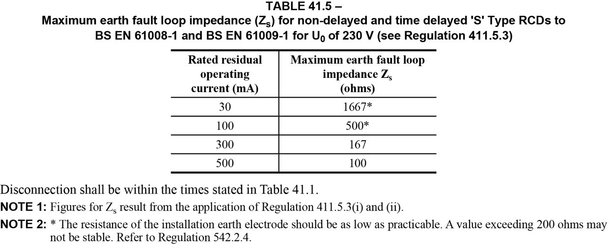

Where RCDs are used for TN systems, Regulation 411.4.204 of BS 7671 states that Table 41.5 may be applied. However, it is important to note that the maximum earth fault loop impedances are derived from a touch voltage of 50 V, not 230 V.
Where RCDs are used for TT systems, Regulation 411.5.3 of BS 7671 applies, which refers to Table 41.5, therefore, RA × IΔn ≤ 50 V.
Figure 2 Maximum earth loop impedance values for TT systems

What testing is required?
Each electrical installation is different, and appropriate testing needs to be selected according to the protective measures. For example, it is common for a residual current operated circuit-breaker with integral overcurrent protection (RCBO) to be used on each circuit for a domestic installation. In such cases, the minimum testing to be carried out is:
  • continuity of protective conductor
  • continuity of live conductors for ring final circuits
  • insulation resistance
  • polarity
  • external earth fault impedance
  • polarity of the supply at the origin of the installation
  • RCD testing.
In this case, the only live testing required to be applied is external earth fault loop impedance, polarity of the supply at the origin of the installation and RCD testing. This requires only one live test at source and one RCD test for each RCD. If Zs testing was carried out, this could increase the amount of live testing needed.
RCD testing should be carried out at the outgoing terminals of the RCD. This is to prevent the wiring or connected equipment from influencing the test results. However, it is often argued that it is safer to carry out the testing with a plug-in test lead at a socket-outlet with no other equipment connected in the circuit. This would remove the need for being exposed to live parts.
Regulation 643.6 of BS 7671 requires the polarity of the supply at the origin of the installation to be verified before the installation is energized. This is a test that can only be carried out live. This test can be carried out at the same time as measuring external earth fault loop impedance. The indicators on a multi-function test instrument will verify polarity at the same time as carrying out an earth fault loop impedance test, so it doesn’t need to be a separate test.
