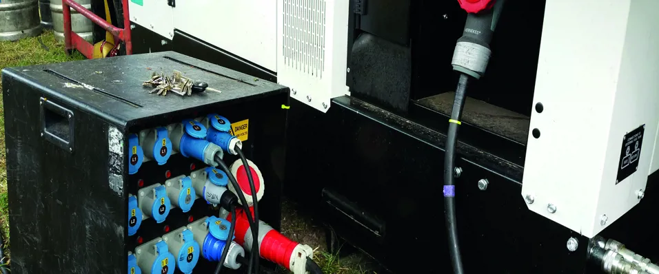

Rather than the energy sources, perhaps the biggest benefit has been the development of large-scale battery storage, with capacities in the region of up to 400-500 kVA available in transportable formats. The use of such systems allows hybridization of generator packages which is important in the move to Stage V emissions compliant diesel engines. Running such generators on low loads often results in unexpected shutdowns as the exhaust temperatures do not get hot enough for the emissions filters to work effectively; hybridizing a system with energy storage allows the generator to work hard for shorter durations, bringing the exhaust temperature up and alleviating the problem. As the generator will usually operate in parallel with the battery unit, it is important to consider earthing arrangements and the effects of circulating currents. Another key aspect with battery systems is their performance under fault conditions – many inverters will not deliver the current required to operate the protective devices in a distribution, so managing protection for faults requires more diligence on the part of the designer.
Along with these issues, the updated guide looks at the considerations around energy storage capacities, as well as how battery units can integrate into generation systems, such as working in a simple hybrid mode or as a mini-grid with other generators operating in a load-on-demand configuration, for example.
On the subject of generators, information on generator control and operation has been updated and now includes guidance on parallel operation of sets, leading power factors and the stability of generator sets powering capacitive loads, such as switched-mode power supplies, as commonly found in most modern equipment and lighting. The (often vexed) question over generator earthing – or lack of – has been significantly revised to take into account the previous work published in the IET Practitioner’s Guide to Temporary Power Systems. Importantly, the requirements for specifying appropriate earth electrode resistances are explained, along with the typical failure modes experienced with temporary systems.
