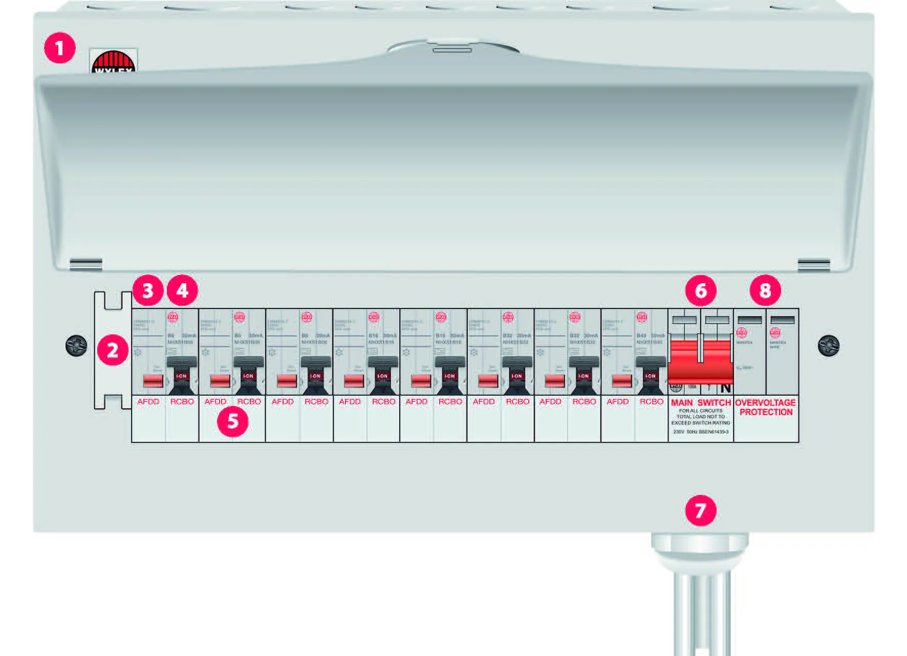

Image credit: Electrium
- Metal enclosure (For fire protection)
- Blanking modules (To prevent access to live parts)
- AFDD (Arc Fault Protection)
- RCBO (Residual Current Circuit Breaker with Overcurrent protection)
- Circuit labelling (identification purposes)
- Main switch (For isolation purposes)
- Main supply cable entry point
- Surge protective device (For protection against overvoltages)
