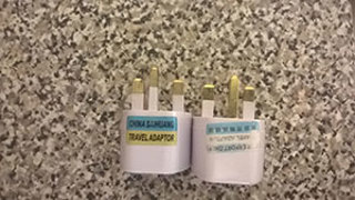

There are a number of precautions you can take, and advise your family, friends, colleagues and customers to take, such as only purchasing from reputable suppliers, checking the packaging and labelling. It is also worth checking whether:
  • the package been tampered with
  • all the regulatory information is present
  • there are any misspellings – which can be a real giveaway
  • the feel of an item or the extension cord raises your suspicions, and
  • the product has a kitemark – its absence should be cause for alarm; likewise, look out for a poor imitation of the genuine mark.

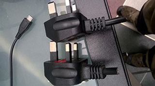

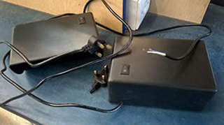

They may look like the real deal but fake goods pose a safety risk as they often contain faulty parts, are of poor quality and are, in most cases, dangerous. Most common are chargers for mobile phones – Hawkesworth has failed over 12,000 chargers and AC adaptors due to them being flawed and/or fake. Laptops, computers, heating appliances, air conditioning units and kettles are also products that have been failed – in fact, we have failed anything that requires a plug!
There are a number of giveaways that any electrical engineer will be able to use to tell fake appliances from the real deal. Comprehensive testing, including a polarity check, will identify the tell-tale signs of potentially hazardous faults such as physical damage, non-standard cable joints, loose connections, missing screws, overloading of sockets or over-heating.

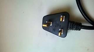

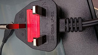

There are other obvious signs for spotting dodgy electrical appliances, like Earth pins that are partly or fully insulated. Earth pins should never be insulated – only the Live and Neutral.
