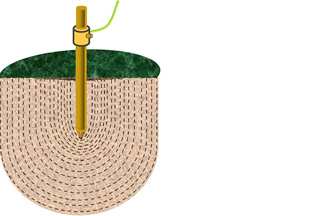

Figure 1 – A simple earth electrode
The simplest earth electrode used in the UK is a straight rod driven into the ground (see Figure 1). Item 1 is the rod and item 2 identifies the rod/soil contact surface. Initially this contact surface area is quite small and is the surface area of the rod in contact with the soil, but it should be noted that as the current travels away from the rod the surface area ‘layers’ (item 3) of the soil can be considered to get larger in area. As the resistance at a point is inversely proportional to the area at that point, the electrode resistance can be considered to be in the form of:
where:
R  =  electrode resistance in Ohms.
ρ  =  soil resistivity in Ohm meters (assuming a uniform soil).
L  =  length of electrode buried in soil in meters.
A  =  area in square meters.
From the above, if the soil resistivity is known then the theoretical resistance of a single vertically driven earth rod can be approximately calculated using the formula below.
Where:
d is the diameter of earth rod in meters
other terms are as noted above.
The derivation details of this and other electrode formulae can be found in BS 7430:2011+A1:2015 Code of Practice for Protective Earthing of Electrical Installations.
The above formula can only give an approximate value as there are always other factors to consider. For example, the soil resistivity is unlikely to be known with any accuracy and it may vary with depth. Seasonal changes in moisture content will also have an effect. The depth that the rod can be driven will depend on the soil conditions (rocks etc.) and the need to get to soil of suitable resistivity. For example, in the Middle East it is usual to drive a rod to below the level of the summer water table as the dry ground above has an extremely high resistivity.
It should also be noted that the length of the rod has significantly more effect on the electrode resistance value than the rod diameter. General data for a range of expected UK soil resistivities can be found in BS 7430:2011+A1:2015.

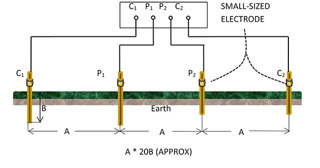

Figure 2 – Four-terminal method of measuring earth resistivity
From these basic electrode calculations it can be seen, as detailed in Figure 2, that if the spacing (A) between the actual installed electrode C1, the temporary C2 test electrode and the intermediate P1 and P2 test electrodes was large compared with the driven depth (B) of the installed electrode C1 (say, A is more than 20 x B) the general soil resistivity can be calculated from:
where:
ρ is the resistivity in Ohm metres.
R is the earth electrode resistance reading in Ohms.
A is the spacing in metres between the test electrodes.

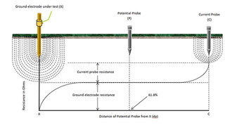

This is known as the ‘fall of potential’ method and it can be seen in Figure 3 below that most of the voltage is dropped around the electrodes where, as outlined above, the soil ‘layers’ are small around the electrode and therefore holds the majority of resistance. In the area between the electrodes there are a multitude of current ‘paths’ and the area (A) is very large so the change in resistance is very small.
Figure 3 – Illustration of the fall of potential method of electrode resistance measurement

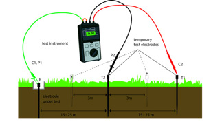

Modern testing equipment works on this principle but it is designed by instrument manufacturers to be more compact and easier to use.
Figure 4 – Typical earth electrode test using a three or four terminal tester
