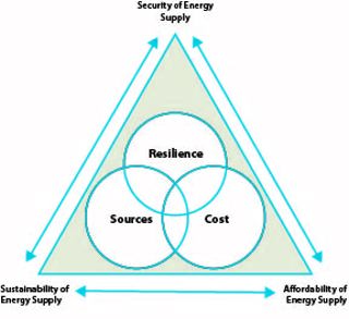

Figure 1 Energy trilemma - reproduced from the IET’s Guide to Energy Management
Despite the complexity of some of the issues involved, doing nothing and carrying on as normal – typically classified as ‘business as usual’– is not an option when considering energy management. Rising energy prices and security of supply now pose major risks to business and need to be managed. So, what exactly are the challenges that need to be overcome?

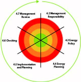

Figure 2 – The components of the continuous process of ISO 50001 that are an integral part of a much wider picture – reproduced from the IET’s Guide to Energy Management
System
For energy management to succeed there must be a process-driven system to facilitate change supported by technology that closely assesses what, where, why and how the energy is used. Careful monitoring and analysis will identify areas and opportunities for improvement.

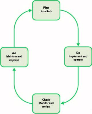

The international standard ISO 50001 – Energy Management provides a framework for an energy management system using the universal model of ‘plan, do, check, act’ that is often adapted to manage improvements in the engineering world.
Figure 3 Plan, Do, Check, Act cycle – reproduced from the IET’s Guide to Energy Management
However, facilities managers need to be aware that there is no single solution. A robust energy management system should:

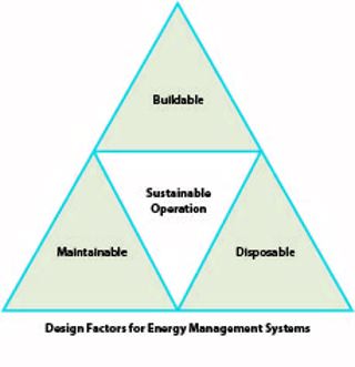

Passive measures – design and building fabric
Modern building designs are governed by regulatory parameters (for example, UK Building Regulations and similar design criteria); these have backstop values for the thermal performance of building elements (u-values) and the efficiency of HVAC and lighting. However, the building needs to reach an overall building energy performance that can be achieved by passive design, and the use of low carbon technologies and renewables.
On older structures, this is not always as straightforward. To reduce energy demand, one of the main challenges then becomes dealing with the building fabric and its constituent elements. Although building science dictates that the fabric should be dealt with first, the economics don’t usually add up unless you have already planned an upgrade and all you’re doing is upping the specification – this is normally a comfort decision (i.e. maintaining the working environment) or protecting the asset. Both are a legitimate part of the business case as they ensure the value of the asset and, if rented out, maintain rental values and reduce void times. If the project is standalone often the only cost-effective measures are controls and pipe insulation. Plant comes into the picture only if it is at the end of its service life or an upgrade is planned.
A holistic approach to refurbishment is always advisable where all measures that will contribute to successful energy reduction are considered together, but be wary of creating other problems through ill-conceived initiatives.
Figure 4 Design factors for energy management systems – reproduced from the IET’s Guide to Energy Management
