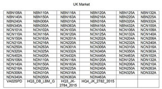

Check if REFERENCE of product is in list below

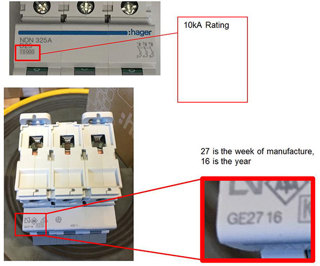

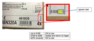

1. Check current stock for any identified products on the attached return form, manufactured between 7th of July 2016 and 25th of September 2016, and remove all non-conforming items from sale.
2. For products in the original carton the date code is identified as shown: The 8-digit code is Year/Day/time
3. For product which is not in the original carton the 10kA rating can be identified as shown below. There is a date code on the MCB located on the top surface above the grey actuator. This relates to the week of manufacture as shown below:
If the code is shown on the table below, then please return stock to Hager.
