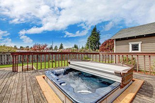

All electrical work should comply with BS 7671. There are no specific requirements for electrical installations associated with hot tubs in BS 7671. However, where a hot tub is located outdoors in the open air, for example, a garden, IET Guidance Note 7 Special Locations recommends that the requirements of Section 702 (swimming pools and other basins) should be applied. The requirements for swimming pools are given in Section 702 of BS 7671:2008+A3:2015. IET Guidance Note 7 also sets out the risks. Persons involved in the design of the electrical installation for a hot tub should consult the product standard BS EN 60335-2-60: Specification for safety of household and similar appliances: Particular requirements for whirlpool baths and whirlpool spas.
Supply
The supply to the hot tub should be protected by a 30 mA RCD. The cable must also be suitably protected along its route. Regulation 522.8.10 sets out the requirements for buried cables. Cables should be protected against foreseeable damage, either by armouring or by suitable enclosure. Unprotected cables should not be buried directly in the ground, nor should they be clipped to wooden fences etc., as such an arrangement may provide inadequate support and protection.
Problems arise when ground levels are either lowered so that cables have insufficient cover, or raised so that cables that were not intended to be buried and are not suitable for burial become buried. Such problems can arise during the course of a project and the intended ground level should be formally ascertained before the cables are installed. It must be remembered that the layout of a garden can be changed totally within a few seasons and great care must be taken to route cables where they are not likely to be disturbed or damaged, for example, around the edge of the plot and at sufficient depth.
Buried cable routes should be identified by local route markers and recorded on drawings. Cables should be buried at least 500 mm below the lowest local ground level, and a route marker tape laid along the cable route about 150 mm below the surface.
