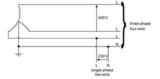

Note that a single-phase reduced low voltage supply does not have a neutral conductor. Consider a 230 V AC single-phase supply where one pole of the supply is earthed; this is usually at the transformer on a TN or TT system. The below figure shows the conventional UK supply system.
UK supply system
This connection creates a conductor we reference as neutral. On a reduced low voltage system there is no neutral; the centre point of the transformer’s secondary winding is earthed, so, each leg of the circuit emerging from the transformer is at equal potential to each other with respect to earth.

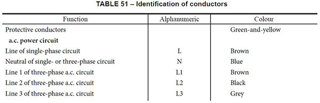

Regulation 514.3.1 states that conductors shall be identified by colour or by an alphanumeric method. Further, Table 51 of BS 7671:2008+A3:2015, Identification of conductors, sets out the standard method; extract here:
Where colour is used to identify the conductor, the line conductor of a single-phase circuit is identified with brown; neutral is identified with blue. However, there is no neutral conductor in a single-phase reduced low voltage 55-0-55 V system; therefore, no neutral means no blue conductor. As both live conductors of the circuit are at exactly the same potential with respect to earth, i.e. 55 V AC, they would, therefore, need to be the same colour. Remember, these conductors are not of different phases, there is no angular displacement between them, they are two poles of the same phase; therefore brown is used for each conductor.

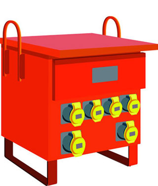

Typical 110 V (55-0-55) power assembly
Summary
Reduced low voltage systems are used extensively in construction sites, workshops and for supplies to laboratory equipment. Socket-outlets on a single-phase reduced low voltage circuit will have three conductors; the protective conductor will be identified by green-and-yellow markings whilst the two current-carrying conductors, also known as live conductors, will both be coloured brown where colour is used as the identifying medium. There is no requirement to maintain polarity between the live conductors.
