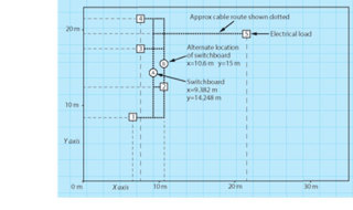

The Barycentre method equation for 2D layouts is as follows:
If we take an example of a workshop with five loads as follows:
Figure 1 - Plan view of workshop
The EAC in kWh for the above loads, which are used at different times, is therefore determined as follows:
kWh = kW × h
According to the Barycentre formula:
The Xb position of the Barycentre (for the switchboard location) is given by:
The Yb position of the barycentre (for the switchboard location) is given by:
The location of the switchboard (item A) and the loads (items 1 to 5) and cable routes have been plotted in their approximate locations on the plan layout of the workshop (Figure 1). The estimated lengths of cables (in this example) from the switchboard to loads are given below. Please note these are only very approximate lengths. It is important to be aware that in practice it may not be possible to run cables via the optimum route due the building construction.
Load 1= 9 m, load 2= 3.5 m, load 3 = 5 m, load 4 = 9 m, and load 5 = 17 m.
Just as a comparison, if we use the power consumption of the load rather than the EAC in kWh, and in this example we use kW, we get:
The Xb position of the Barycentre is given by:
The Yb position of the Barycentre is given by:
The location of the switchboard (item B) and the loads (items 1 to 5) and cable routes have been plotted in their approximate locations on the plan layout of the workshop (Figure 1). The estimated lengths of cables (in this example) from the switchboard to loads are given below. Please note these are only very approximate lengths. It is important to be aware that in practice it may not be possible to run cables via the optimum route due the building construction.
Load 1= 11 m, load 2= 2.5 m, load 3 = 5.5 m, load 4 =9.5 m, and load 5 = 15.5 m.
In this particular example using the load in kW compared to the using estimated annual consumption in kWh gives slightly different cable lengths.  The difference could be far greater in other situations depending on the annual hours of use of the various loads.

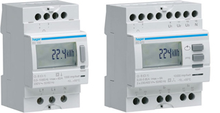

How metering information will be used needs careful consideration. The system may be required to measure power quality, voltage levels and loads. It may also produce alarms, control loads or change tariffs if preset limits are exceeded.
To be able to measure the amount of electrical energy consumed and to monitor and control energy effectively, metering equipment needs to be allowed for at the planning stage. Although this will increase the initial cost of the switchboards, it will prove more economical than having to add metering equipment at a later date.
Consideration should be given to the environment in which the metering is installed, which should be in accordance with the manufacturer’s instructions. Metering needs to be installed in an area that is accessible for the meter reader where the display can easily be read. Areas where the instruments are likely to be subjected to excessive heat, moisture, and vibration should be avoided. Meters are available that provide pulse generation. These can be linked to building management systems to provide an electrical pulse proportional to a unit of measurement.
Essential to the operation of the meter is the current transformer (CT). The function of the CT is to transform the high current levels to match the input requirements of the meter. In most cases the input value of the meter is 5 A. For example, the rating plate of a CT may show 400/5. The high value represents the maximum current of the circuit and is referred to as the primary value. The low value is referred to as the secondary value.
The accuracy is expressed as a percentage i.e. class 1 is 1 percent, class .5 is 0.5 percent.

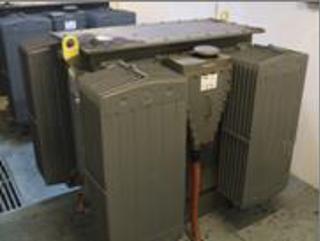

IEC 60364-8-1 advises that the choice of an energy efficient transformer may have a significant impact on the energy efficiency of the whole installation. There are basically two types of losses in transformers. These are iron losses and copper losses. Iron losses occur in the magnetic core of the transformer, causing it to heat up. Iron losses can be divided into two components: hysteresis losses, and eddy current losses. In general it is understood that iron losses of a transformer remain constant regardless of load conditions, which means that the iron loss on no load will be the same as the iron loss on full load.
Copper losses (load losses) are due to the heating effect of the primary and secondary currents passing through their respective windings.
No-load and load losses in a transformer result in a loss of efficiency. They are the reason for the major running cost of a transformer. They result in heat that is normally dissipated to the atmosphere. Load losses depend on the load factor (LF). Consequently, a key requirement when considering energy efficiency is to decide on the load factor of the transformer at the planning stage in order to run the transformer at its most efficient.
IEC 60364-8-1 advises that the maximum efficiency of a transformer is when the iron losses and copper losses are equal. The standard advises that usually, the maximum efficiency of a transformer corresponds to 25 % to 50 % of maximum power rating of the transformer. Persons involved in this work should seek expert advice.

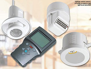

Lighting controls for residential buildings are easy-to-install devices that are able to detect the presence of people and only switch on lights when required. Lighting controls eliminate wasted energy and save energy simply by switching lights off when not required. Lighting controls for commercial, public and industrial buildings are again easy-to-install devices that are able to automatically switch off lights when no occupants are detected or there are suitable levels of natural light.
When considering the design and installation of lighting controls there are a number of important points to consider. First, it is important to take into account the type of space, how it is used and the amount of daylight available. The type and use of space will determine the type of sensor and therefore the control used.
Safety is also an important consideration. The operation of lighting controls should not endanger the occupants of the building. This may happen if a sensor switches off all the lighting in a space without daylight. It is therefore important that lighting controls are designed correctly to ensure the safety of occupants and save energy.
Commissioning should be included as an essential part of the installation of lighting controls. Commissioning could include calibrating photoelectric controls, checking that occupancy sensors are working, and setting a suitable delay time for occupancy sensors.

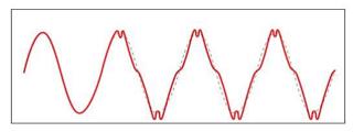

Harmonics are a steady-state disturbance compared with, for example, short-term transient overvoltages. Harmonics are generally caused by non-linear loads, such as switched-mode power supplies of computers and discharge lighting (see Figure 3). Regulations 523.6.1 and 523.6.3 of the 17th Edition recognise the effect of triple harmonic currents in the neutral conductor and the need to take account of it. In electrical installations, there is a particular problem in three-phase circuits.
The third and other triple harmonics combine in the neutral to give a neutral current that has a magnitude equal to the sum of the third harmonic content of each phase. The heating effect of this neutral current could raise the temperature of the cable above its rated value and damage the cable.
Other harmonics can cause problems with electric motors, causing the frame temperature to rise and, consequently, reducing the life and efficiency of the motors. With the increased use of switched-mode power supplies the resulting harmonic distortion is a major concern. It is therefore important to be able to measure the power quality and, where harmonic distortion is found, provide a solution to reduce the harmonic distortion.

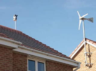

On-site renewable energy sources do not of themselves increase the efficiency of the electrical installation but reduce the overall utility network losses as the consumption of the building from the utility is reduced.
There are a wide range of microgeneration technologies, including solar photovoltaic (PV), wind turbines, small-scale hydro, and micro CHP (combined heat and power). Microgeneration systems such as solar PV installations should always be carried out by a trained and experienced installer. For example, where the PV panels are roof-mounted the roof must be strong enough to take their weight, especially if the panel is placed on top of existing tiles. It is also important to note that there are mandatory requirements concerning the parallel connection of generators with the supply network.
