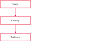

Ensuring that an installation is safe enough to allow satisfactory operations and has sufficient capacity for existing needs has typically been enough for most installations. Some installations, with safety-critical operations, may also have considered resilience to avoid single points of failure and provide system continuity. This means that, until relatively recently, the traditional model of an electrical installation design hierarchy would have been:

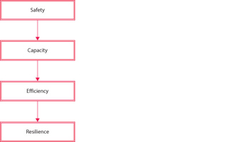

Energy efficiency updates the hierarchy of design, and that affects the operation of electrical installations. The traditional design hierarchy will change to this:
There is a change of emphasis to incorporate energy efficiency into electrical installation designs as a prerequisite, not just as an aspiration.
Future electrical installation designs will still need the required level of safety and capacity; they will also require the lowest possible electrical consumption.
