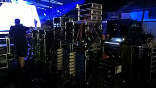

Almost theatre, but not quite – backstage lighting dimming, distribution and control for the BBC EU Referendum debates in Wembley Arena.

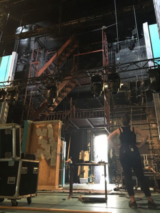

Different scenic and technical elements jostling for position halfway through a show build.
Nick notes that “whilst the lighting design is not your responsibility as the production electrician, an understanding of it is essential to be able to specify and manipulate the equipment in such a way as to make its delivery possible.”

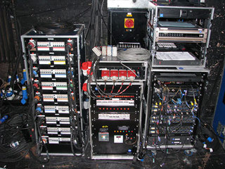

The electrical equipment used on theatre productions is very much of a ‘plug and play’ nature. This is to enable the quick assembly of systems and to be able to take them apart again quickly too. Often this needs to happen in a few hours overnight, possibly the day before putting it all together again a couple of hundred miles away.
Mains distribution equipment backstage. The rack on the left is a 108 x 10 Amp channels of single phase power distribution, in the centre is a 16 way three-phase distribution unit, the rack on the right is control data distribution.
The starting point of the electrical design is really concerned with the safe loading of these distribution systems when they are hooked up to the power supplies available in the theatres that the show is visiting, the electrical characteristics of which are often unknown. Nick explains:
“A sensible level of discrimination is necessary, both from a safety point of view (earth faults, isolation and switching etc.), but also from the point of view of user friendliness and ease of operation. Given that these systems are being repeatedly taken apart and put back together by different crews each week (albeit under the supervision of the production electrician), the system needs to be robust and clearly labelled to make sure it is assembled as per the specification each time.”
A certain amount of flexibility needs to be designed into that system too. You can be sure that, certainly in a show's early days, there will be changes to the lighting design. The creative team are not generally concerned about how many spare ways you have left on your distribution equipment or dimmers. Nor do they worry about how you are dealing with phase balancing during a show where the demand is constantly shifting as different lights are used in the different scenes being played out onstage. From a design point of view, they might suddenly require the biggest light they can find to be rigged in the most inaccessible position possible, where you previously had no power or data infrastructure in place.”
