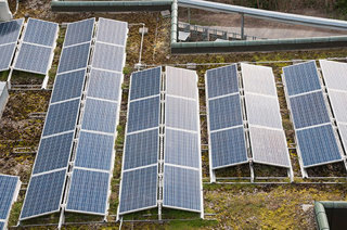

There is a catch. You can only sell an end-user as much power as they need. This means that solar and wind systems are likely to be smaller and more bespoke to customer demand and will, therefore, require careful analysis. When we are looking at this for clients we take the half-hourly metered data to understand what their minimum daytime demand is. This dictates how big a solar or wind installation should be alongside other metrics.

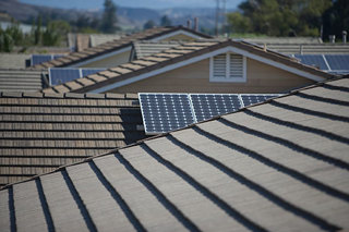

The good news is that there are likely to be a lot more solar and wind projects in the future, but they are more likely to be a lot smaller and more complex. This in itself is probably good news for electrical installers as the work will be more valuable and more bespoke. For solar it is likely to drive more rooftop installations, supplying the occupier in the building. Rooftop installations are more complex than ground-mount systems due to the access, safety, connections (electrical and physical) and the roof layout itself.
To add to the complexity and opportunity, energy storage is now becoming available, commonly in the form or lead-acid or Li-ion batteries. This is really exciting for the power sector as a whole, and in renewables, it offers a range of opportunities for solar and wind projects that are serving sites. For example, it may mean that you can increase the size of a solar/wind system and simply store excess energy when you don’t need it and then use it when you do. Further, due to the additional charges that apply for electricity at peak periods of demand, there are extra savings that can be made.
