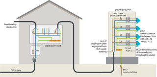

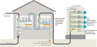

As mentioned previously the ESQCR prohibit the connection of a PME earthing facility to any metalwork in a leisure accommodation vehicle (caravan). If the caravan supply is derived from a permanent building that is supplied by a PME system then the caravan supply will have to be part of a TT system having a separate connection to Earth independent from the PME earthing.
The separation of the earthing can be effected at the main distribution board. See the below Figure 7.1 of IET Guidance Note 7 for detailed information. This enables the exposed-conductive-parts connected to each system to be more readily identified and inspected periodically. An earth electrode for the TT system should be provided nearby and located so that the resistance areas of the PME supply earthing and earth electrode do not overlap.
Alternatively, the separation of the earthing can be made at the caravan pitch supply points. In this instance, earth electrodes will be required at these points. See the below Figure 7.2 of IET Guidance Note 7 for detailed information.
