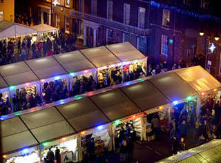

Bury St Edmunds Christmas Fayre

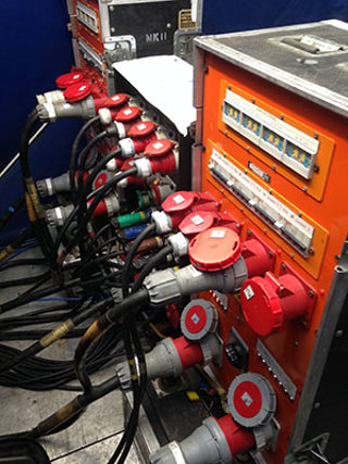

We design all of our distribution, all our rubber boxes are manufactured by SES electrics but we do all the internal wiring and fit our own circuit protection so as to maintain the same standard. All our distribution designs are structured so as to be completely modular and versatile.

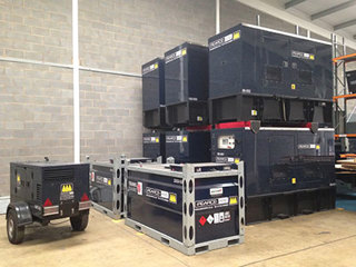

Pearce Hire warehouse - generators and fuel tanks ready for hire!

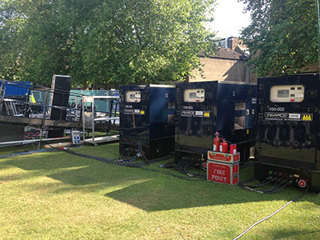

We achieve this in many ways. We only use EUIIIa emissions-compliant generators (they meet the stringent European emission standards for CO2 & Greenhouse gas emissions) and we keep the running hours to a minimum. We continually strive to reduce load and have invested heavily in LED technology in terms of both site and stage lighting. Where possible we also use on-demand generator systems. For example, instead of running a single 300 kVA generator, we use three 100 kVA sets with only one running for 24 hours while the others switch on as the load increases. This significantly reduces fuel consumption and consequently our carbon footprint.
Pop in the Park Cambridge - triple synchronised generator set up

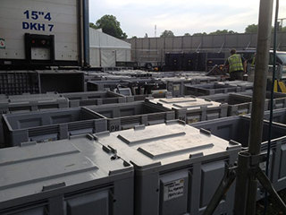

Field Day Festival, Victoria Park, London - equipment bone yard (stores!)
