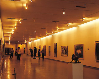

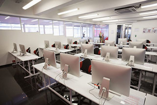

Generally, lighting can be described as either being direct or diffuse. A mixture of direct and diffuse light allows us to determine things such as surface texture or facial features.  Choosing pale matt finishes for walls and ceilings will assist in creating a diffuse element, although a purely diffuse lighting solution can make a space look bland and featureless, whereas a purely direct solution can result in sharp contrast and deep shadows.  A diffuse solution may be the best option for a space where tablet computers are being used extensively as there would be no direct light to reflect on the screen. It wouldn’t really be suitable in a space such as a museum though where lighting is used to guide people and highlight exhibits.

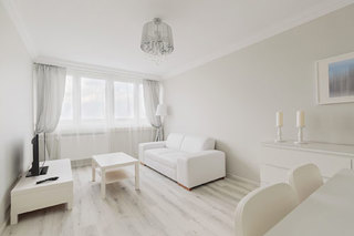

Once a lighting level has been determined, the route to achieving that level, and how uniform it needs to be, can begin. The lighting of a space is affected by the colours and reflectance of the walls and even the furniture, so these factors need to be taken into account. Dark matt finished walls and ceilings will absorb much of the light energy and result in a gloomy-looking space unless the amount of light is increased to compensate. This, of course, increases the amount of energy being used, so it is better to have paler coloured walls and ceilings where possible. Floor coverings can also absorb light and the texture is as important as the colour. For example, a beech-effect laminate floor will reflect much more light than a carpet of a similar colour as the carpet’s texture absorbs light.

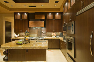

Perhaps the domestic market has been an area where, historically, the need to mix diffuse and direct lighting with a sympathetic colour and texture choice has been misunderstood. Spotlights are often used in kitchens, which provide a direct element for tasks carried out within their beam range but do little to provide a general diffuse element. This can lead to frustrated users of the space, for example, if they want to read a cookbook in an area not covered by a spotlight.

The colour of the light can also have a significant effect. Visible light provided by electric lighting is generally in a range that covers white light with a yellow appearance (described as ‘warm’) to white light with a blue appearance (described as ‘cool’). Cool colours are thought to promote alertness in people whereas warm colours are thought to help people relax. Warm colours in a domestic space and cool colours in an office environment should, therefore, be used, unless there is a specific reason to do otherwise. Wall, ceiling and floor finishes and colours can also affect the overall colour of a space.  For example, a room with blue walls and a blue carpet will still appear to have a cool lighting effect even if warm light sources are used, so matching room finishes to the required lighting effect is important.
