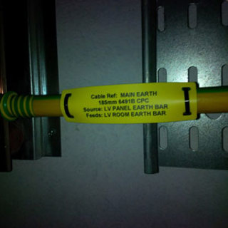

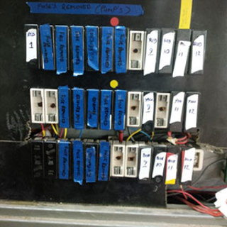

Asset management tools should also be considered. Adequate labelling of cables, switches, isolators and equipment should all be carefully correlated with schedules, drawings and associated documents. Physically tracing cables can be an onerous task, especially in basement walkways and through walls and risers. Adequate labelling of cables, not just at each end, but at appropriate intervals, can greatly assist, especially during reactive maintenance or disaster recovery situations. Labelling that helps the maintainer to instantly understand where the source of supply is can be beneficial in terms of isolating the right part of the infrastructure in a timely manner.
Example of good labelling
Example of bad labelling
