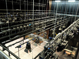

A view from above stage at the Bryn Terfel Theatre, Bangor, ©Arup
At its heart, the use of a performance venue is driven by creative directors, designers and performers. The same stage may have a large-cast musical one night and a single stand-up comedian the next. Consequently, necessity demands that the electrical and associated systems must enable flexible use and do not constrain the artistic vision. Careful planning is needed to provide just the right amount of services and equipment in all the required locations; too much could get in the way or not earn its keep.

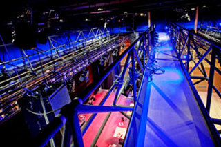

Several systems of containment are required, and these need to be rigorously separated to prevent noisy power associated with dimmers and machinery from introducing noise to sensitive millivolt-level microphone signals. In key areas such as balcony fronts and control rooms, this wiring will have to fight for space and be coordinated with structure and other services. Handling of low noise air demands big ducts that also consume large amounts of space, thereby making early containment planning important. Entertainment technology is constantly evolving and low-fill factors are needed to allow space in containment for future cabling.
Lighting bridges above the auditorium at Mareel Arts Center, Lerwick ©Phatsheep
Associated with this is the way that an auditorium and stage carves a void in the building requiring cables to be routed around a wide, long volume several stories high. All this means that cable runs end up longer than may originally be anticipated, which impacts on cable size to meet volt drop and loop impedance requirements. Care is also needed to ensure data cable run length limits are not exceeded.

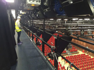

Side stage gallery, Swansea University Great Hall ©Arup

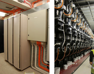

Dimmer rooms, audio rack rooms and motor rooms are usually provided as hubs for the electrical and control infrastructure. These are similar to other plant areas, but dedicated to the specialist systems and with access controlled by theatre technicians.
Dimmer racks at Theatre Royal, Bury St Edmunds / Motor room at Victoria Halls, Singapore ©Arup
