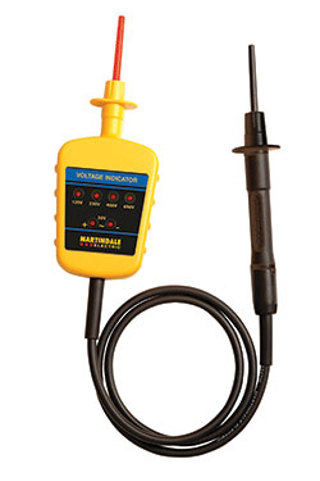

Another primary consideration is whether installers and maintainers have the necessary skills and experience with d.c. installations of the kind being considered. Test equipment and fault-finding practices differ slightly with d.c. circuits; appropriately-rated test equipment must be used. Those using the equipment need to be aware of the limitations of some a.c. equipment settings on d.c. systems. For example, a multimeter on an a.c. setting may read zero if used on d.c. circuits, giving the false impression of absence of voltage. It is important to ensure that voltage testers / indicators used for “proving dead” are suitable for both a.c. and d.c. operation.
A voltage indicator from Martindale Electric
